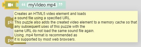

    Thanks for the bones. Yes I am aware of a video being blocked if it has audio. Muting the video was no problem. I use videos as backgrounds all the time. Unfortunately I can not find any puzzle that has a title “load video”. This is where the common sense CAD guy gets lost. I tried using a timer and that didn’t work either. Some of this puzzle stuff is so frustrating.
    #63841

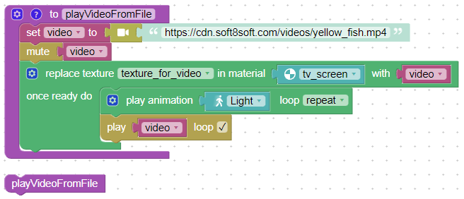

    #63846
    vergecurious
    Well that did it. I had the mute at the bottom and had no idea you had to use a procedure. Thanks so much for your help. I never would have gotten that.
    #63847

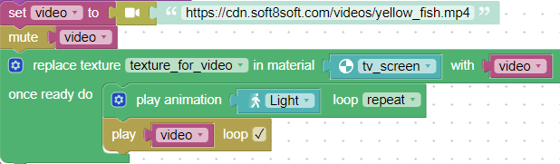

    it’s not necessary. you can use just these puzzles
