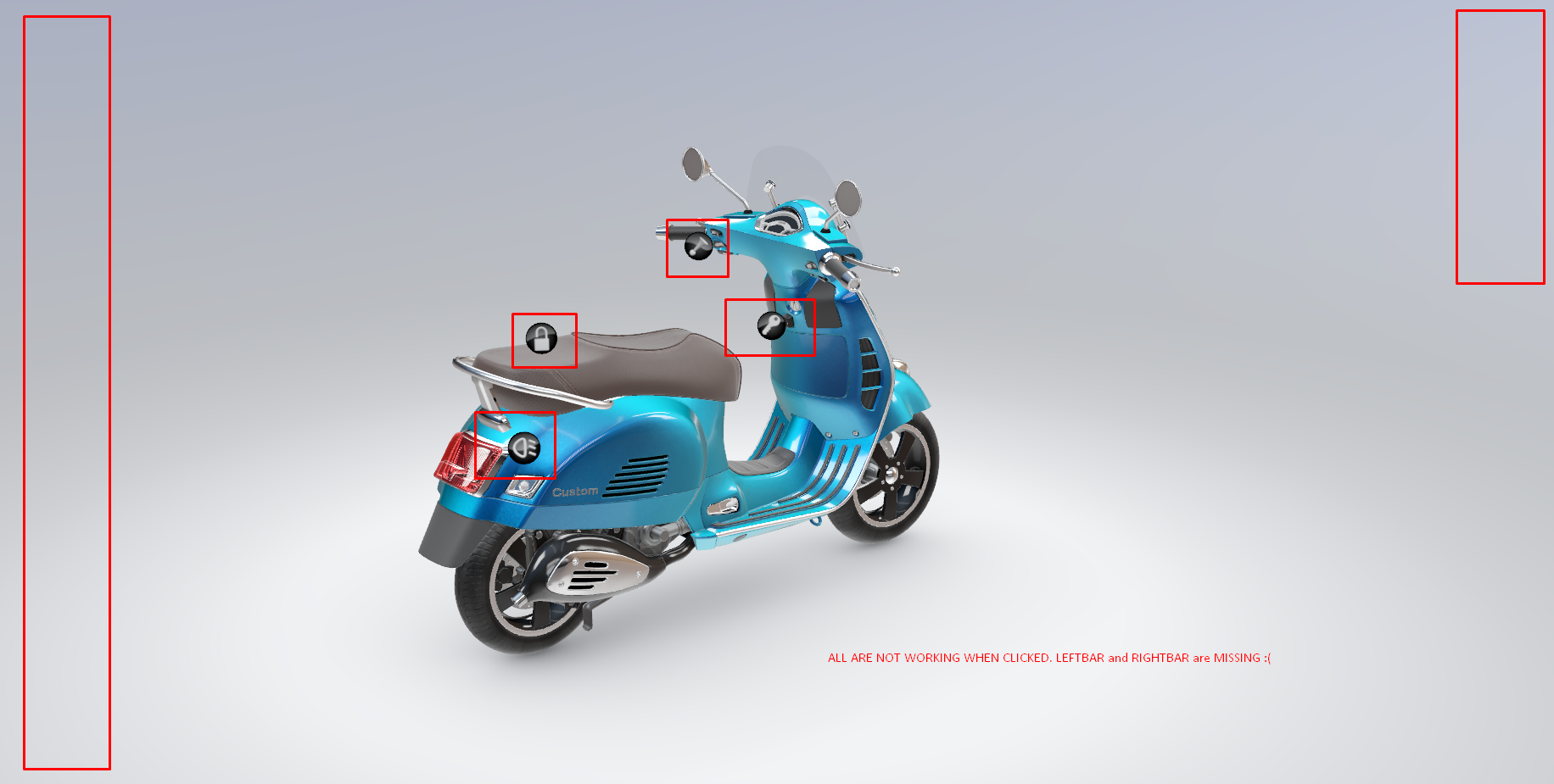

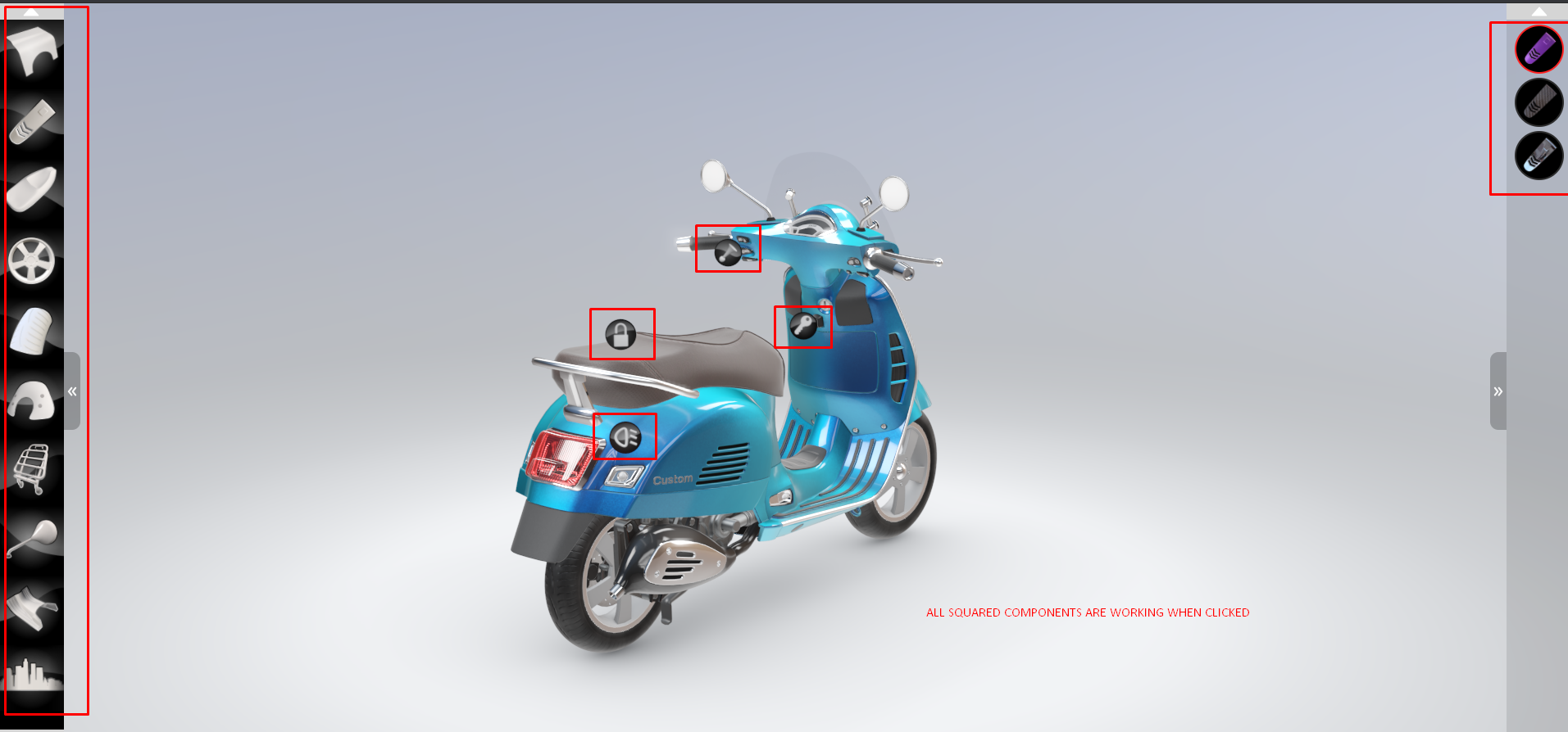

I’m trying to load gLTF file created in Verge3d Max with Puzzles. I followed this documentation but the Logics/Interactions didn’t show
// loaded GLTF 2.0 asset var url = 'template.gltf'; // construct a new application with simple rotating preloader var app = new v3d.App('v3d-container', null, new v3d.SimplePreloader({ container: 'v3d-container' })); // load main scene app.loadScene(url, function() { app.enableControls(); app.run(); runCode(); }); function runCode() { // place your own code here }
And this is my code
const sceneUrl = 'https://cdn.soft8soft.com/AROAJSY2GOEHMOFUVPIOE:251e362e5c/applications/scooter/scooter.gltf'; const app = new v3d.App('v3d-container', null, new v3d.SimplePreloader({ container: 'v3d-container' })); app.loadScene(sceneUrl, () => { app.enableControls(); app.run(); });
The expected output should be the same as in Image1. My output is in Image2.
Am I missing something? I also tried loading the Puzzle with PuzzleLoader and then load the scene but still the same. Please help
Also, I’m using Angular, I was able to load without problems before when I have Verge3d Max 3.0 but when I update Verge3d to the latest version (3.3.1) I now encounter issues.
You must be logged in to view attached files.2020-11-09 at 10:20 am #35153Yuri KovelenovStaffHi,
This particular example consists of 2 .html files. The nav bars are contained in index.html, while the annotations are made as 3D billbords.
Here is more info: https://www.soft8soft.com/docs/manual/en/introduction/HTML-based-user-interfaces.html

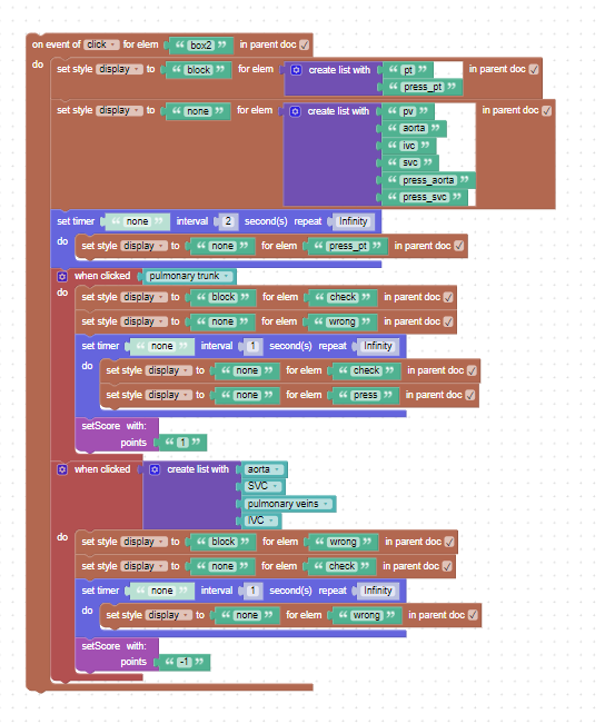

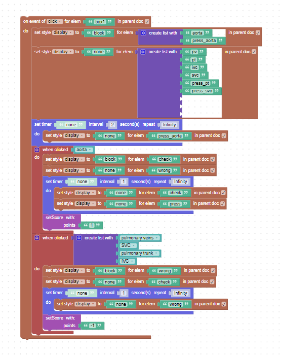

In the Puzzle Events, is there a way to destroy an active event listener? Because what happened is that I have 2 main event listeners for the HTML element and inside of it have other event listeners for the objects (See Image3 and Image4). If the first HTML event listener gets triggered (clicked) I want to make the inner event listeners start listening when the objects get clicked and only those inner event listeners should be active. If the second HTML event listener gets triggered (click) the inner event listeners should be enabled and the other inner event listeners from the other HTML element should be disabled.
So currently when I clicked the “box1” inner events activated (Correct) but when I click the “box2” inner events activated and other events still active (Wrong)
You must be logged in to view attached files.2020-11-13 at 10:36 am #35312Yuri KovelenovStaff2020-11-13 at 10:43 am #35313ninojoevelz(old)CustomerI see. This might work. Thanks
