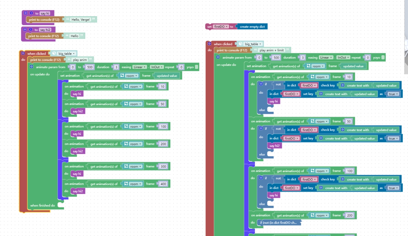

ParticipantI need to perform certain operations at specific keyframes. I’m concerned that this issue could cause stuttering during the playback of my animations.

ParticipantI will use onAnimationFrameDo to execute certain operations at specific keyframes during animation playback, such as moving the camera, showing or hiding objects, and highlighting items. While these actions can execute normally, I feel there’s some stuttering.
I suspect this might be due to the statement part of the onAnimationFrameDo puzzle being executed multiple times. Given the complexity of my animation, it can print up to 200,000 lines of information within just a few triggers.
Here are two tests I conducted: In the first test, the printed output doubled with each repeated trigger, leading to choppy animation playback. In the second test, I implemented a limit on the execution count, which helped to reduce the issue. However, the core DO portion of the code still triggers many times.

https://drive.google.com/file/d/1M1r2OpqDuhRlxqg_Xan8PI60fIMNZAPA/view?usp=sharingYou can reproduce my recorded screen by simply disabling the automatic animation of the official model and using my puzzle instead.

ParticipantOf course, if I segment the animation and use multiple animationParamFrame with whenFinishDo to replace the DO section of onAnimationFrameDo, I can avoid the issues mentioned earlier. I’m considering doing this.

ParticipantI believe I have identified the cause of the “animation stuttering.” It happened because I repeatedly activated animateParam without using stopParam promptly, mistakenly using stopAnimation instead. Now that I’ve utilized stopParam, the animation plays correctly.
I apologize for any inconvenience. Lastly, I’d like to inquire if the data stored in _pGlob.animTriggers is a bit redundant.
