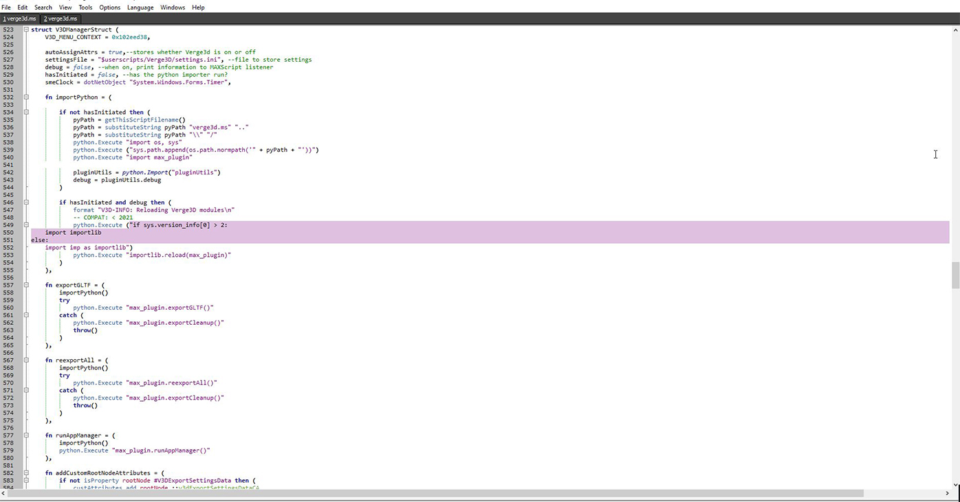

the only thing that makes me wonder is the fact that lately…when i start max..as soon as max is started there appears a window which shows a file , called verge3d.ms…..I exported it as a pdf and attached it here….
I also made a screnshot of part the the verge3d.ms file because in
the original file it show a part which is redly outcolored…as you can see in the *jpg file…..maybe this has something to do with the problem…..if not…maybe you can tell me why it appears..On the other hand….if we cannot solve the problem….it would be a shame….but not really bad…because the application is meant to be running locally on my customers hardware….meant for a planetarium.

i did remove the line….nothing changed…
the script file is still coming up when i start Max…
