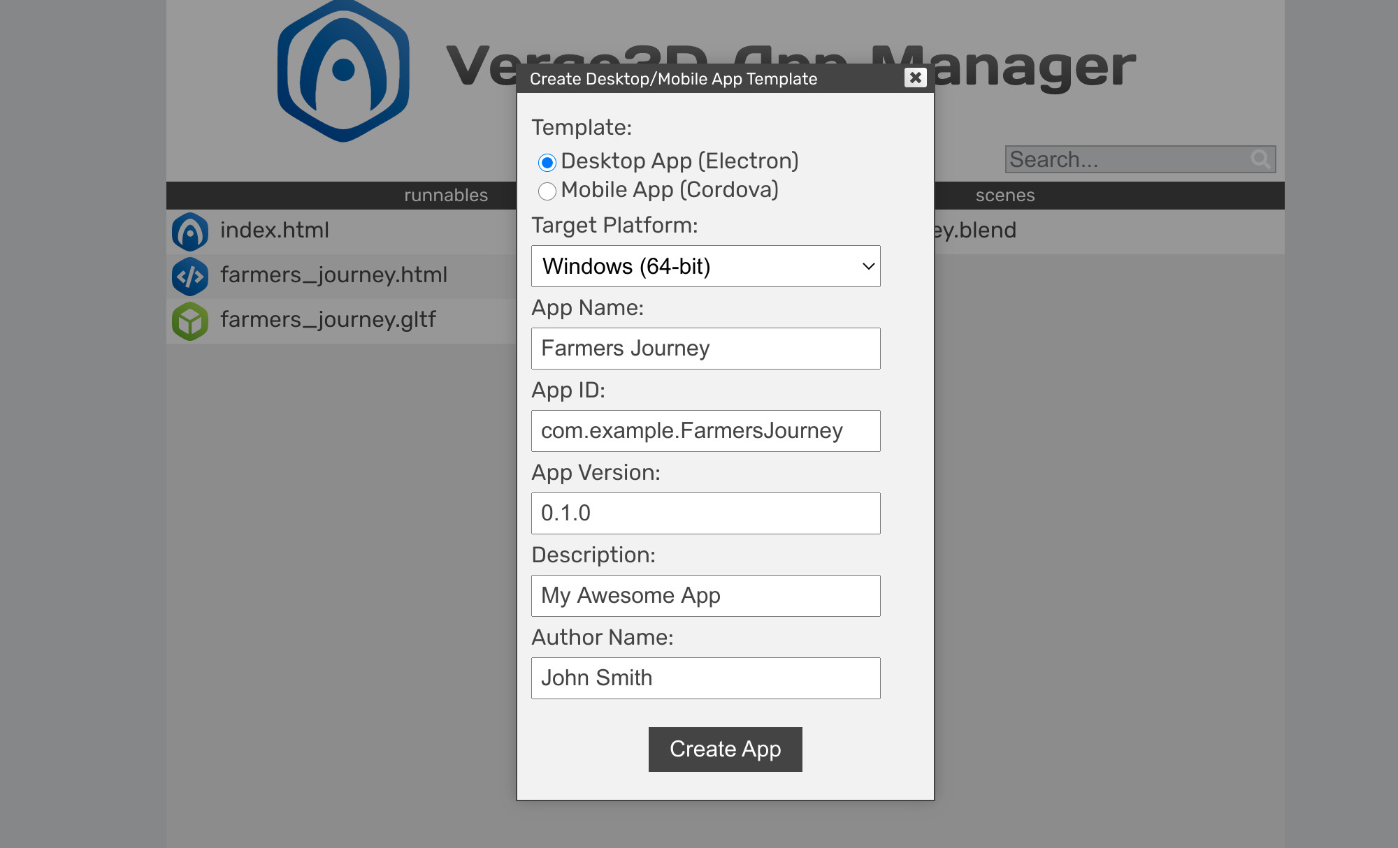

Creating Application

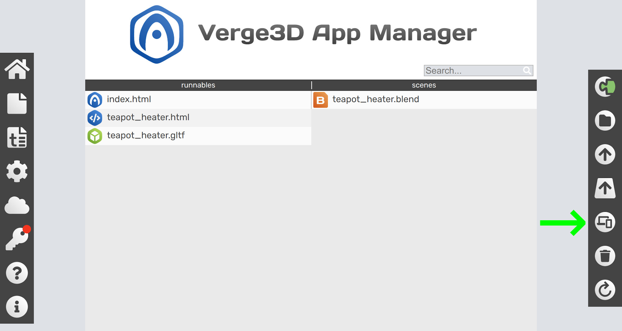

Electron can be installed via NPM or downloaded from the internet. To simplify things up, we integrated an Electron app builder right in the App Manager.
By using it you can download Electron binaries for the selected target platform and then build a ready-to-use application right from your Verge3D app.
Since the number of available platforms is huge, use the following memo to get what you really need:
- None (npm package)
- Build an npm package instead of the ready-to-use executable. The option is for advanced users who are familiar with the NPM utility. Follow the instructions below to continue building your app.
- Windows (Intel, AMD)
- Windows 10 or later, running on devices with 64 bit Intel/AMD processor.
- Windows (ARM)
- Windows 10+ running on devices with 64-bit ARM processors.
- macOS (Apple Silicon)
- macOS 11 (Big Sur) or later, Apple Silicon (aka M1-M5) Macs.
- macOS (64-bit)
- macOS 11 (Big Sur) or later, Intel Macs.
- Linux (Intel, AMD)
- Linux running on 64 bit Intel/AMD processor (Ubuntu, Fedora, Red Hat, etc).
- Linux (ARM)
- Linux running on 64-bit ARM devices.
Due to architecture limitations of the Windows OS, it's not possible to build macOS apps on that system. Please use macOS or Linux instead.

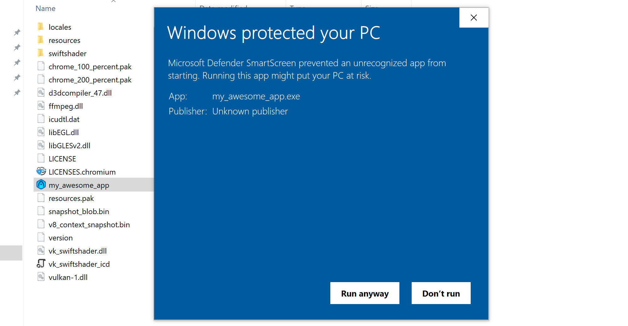

Keep in mind, that since your application is unsigned, both Windows and macOS (but not Linux) prevent it from running. For example, on Windows, you'll see the following Windows protected your PC dialog:
Click on the More info link, then Run anyway to run the application. In order to fix this issue, expecially when you distribute your work to the end users, your app must be signed. See more in the code signing section of the Electron documentation.

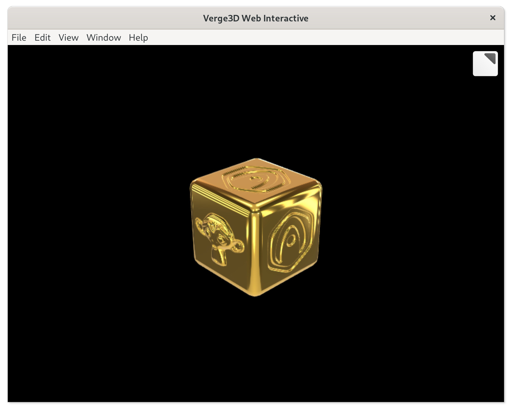

Modifying Application Name and Icon
See the official Electron guide on how to rename your application build and assign a custom icon.

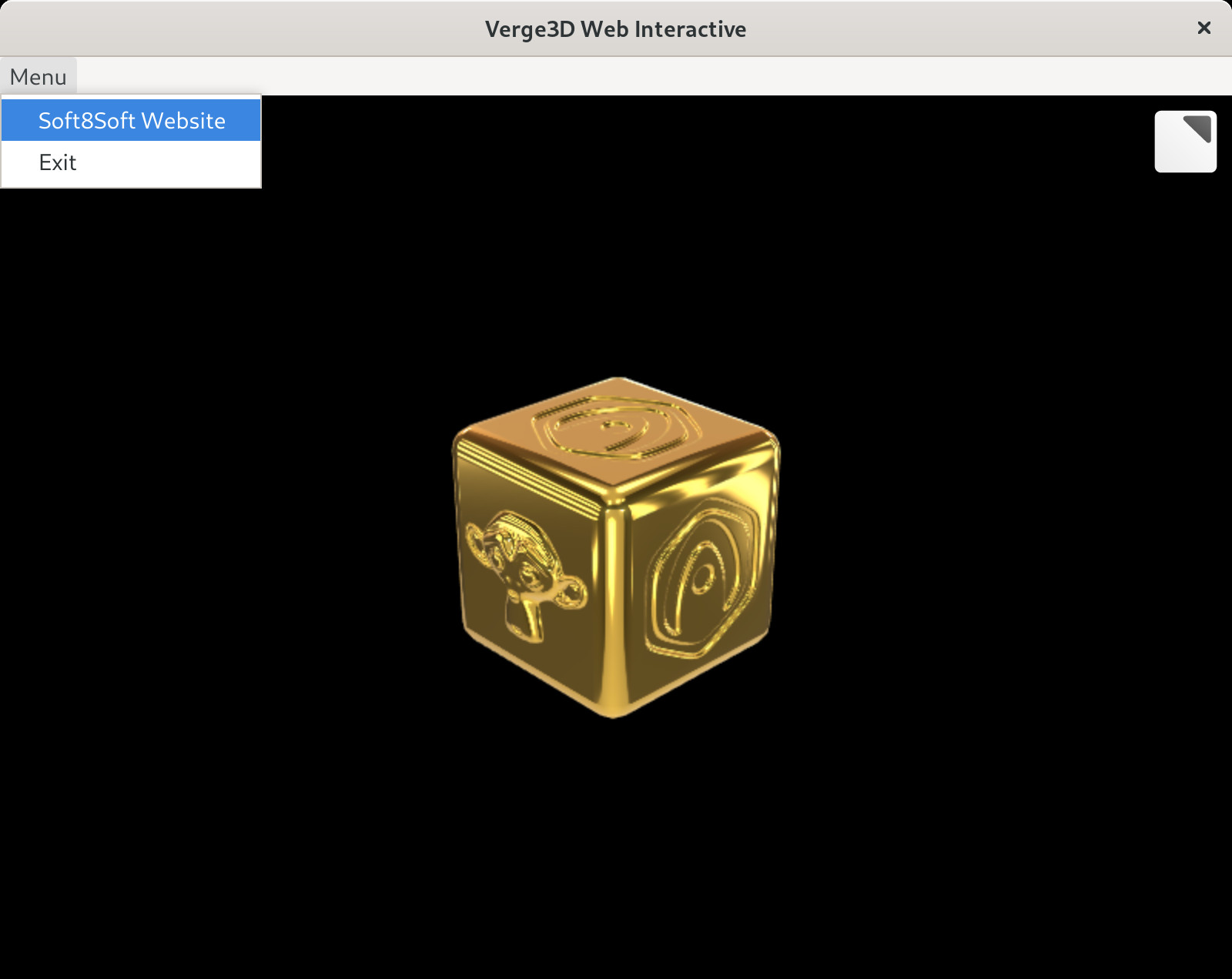

Customizing Menu
To disable application menu altogether, insert the following line in the main.js right after the loadFile() method:
win.removeMenu();
To create your own menu, first connect Menu module to your application:
const { Menu } = require('electron');
We're going to use shell module to open external website upon menu click. So, add shell module here as well:
const { shell } = require('electron');
Then add the following code to the main.js right after the loadFile() method:
const menu = Menu.buildFromTemplate([{
label: 'Menu',
submenu: [
label: 'Soft8Soft Website',
click() {
shell.openExternal('https://www.soft8soft.com');
label: 'Exit',
click() {
app.quit()
Menu.setApplicationMenu(menu);
See the example of the modified main.js file here.
Place the modified main.js in your application folder, then run the app builder again. You should get the following:
