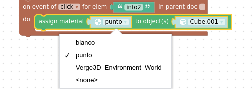

    It’s first time that in puzzle disappear a blender material (material with image jpg) , and i don’t know how .
    Does anyone know this problem? and do you know how to fix it? (looks like a bug) :scratch:
    Thanks in advance

    Emma
    I put here example.
    The cube starts with image.
    There are 2 buttons, with white the cube becomes white (obviously eheheh), with image the image of the dog should return.
    #42074

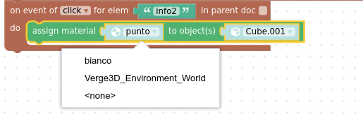

    Emma
    Here 2 screenshots where material disappear …
    #42077
    I think it happens because this material was only on the cube and you replaced it? so it’s gone. Put it on any invisible object too?
    #42078
    Emma
    Good , I try it immediatly
    #42079
    Emma
    Great, work it !!
    Thanks Mikhail !!
