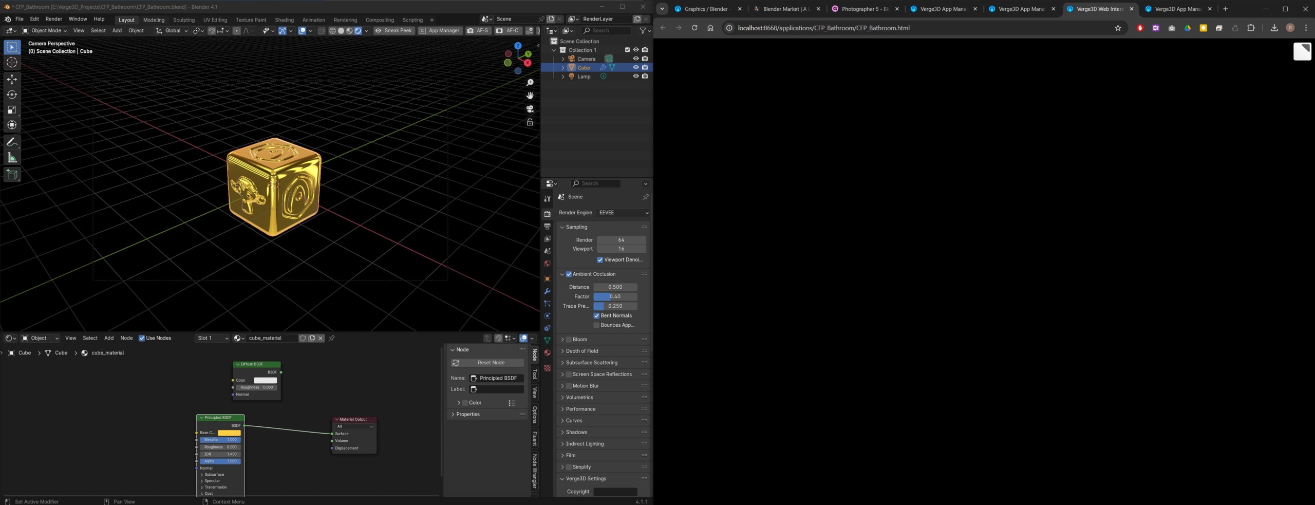

ParticipantHi there,
I’m using Blender 4.1.1. and Verge 4.6.0. on Windows.
When I try to look at my scene or even the dark template, objects with principled BSDF disappear, as soon as i export the scene to gltf. I’m really puzzled. Any ideas why that might be?
I even tried a scene from a friend. It works until i do a gltf export on both of my PCs.Attachments:

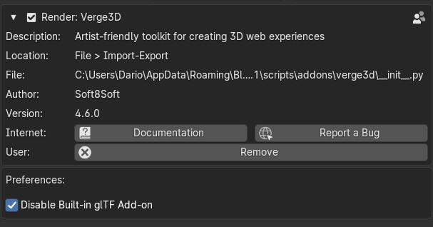

ParticipantBut I have Verge3D 4.6.0 installed…

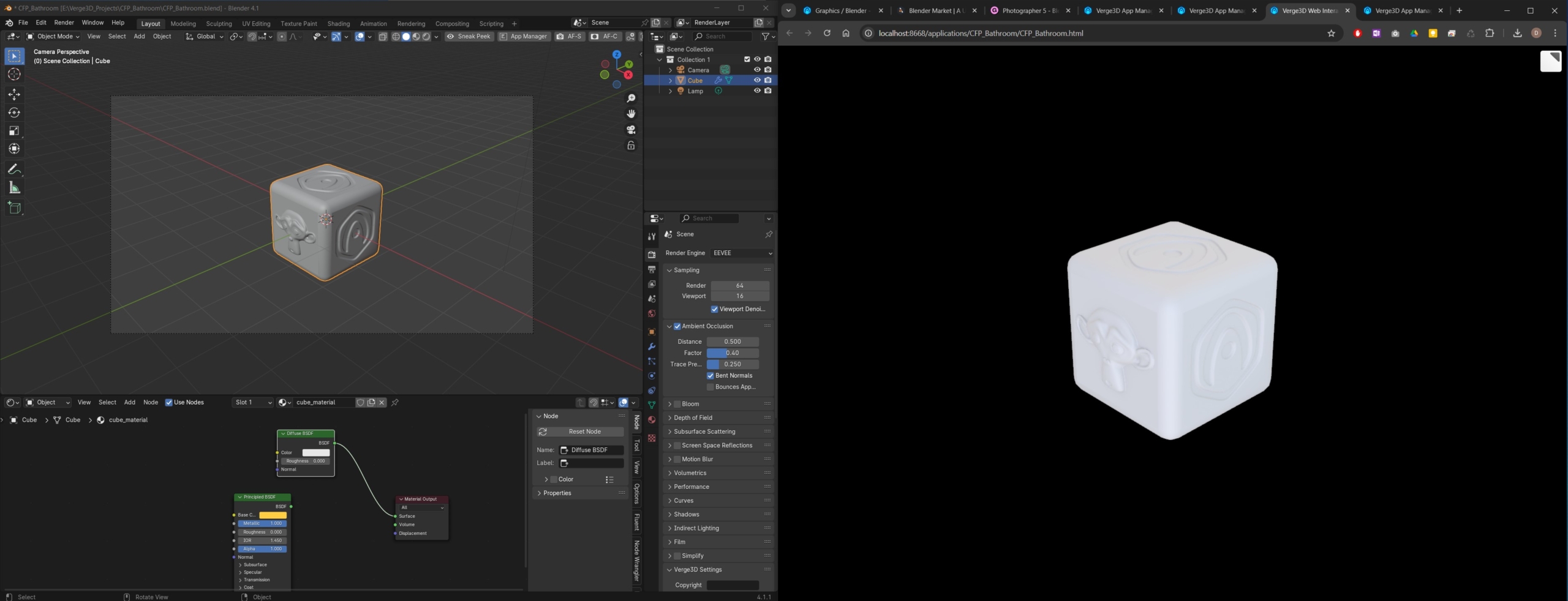

2024-08-05 at 9:31 am #76393chirio
ParticipantWell I tried the update function in the App Manager. This seemed to work for now.
