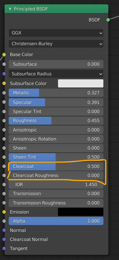

    we just upgraded one of our projects to verge3d 3.4.0 (from 3.3.1).
    when exporting & opening with the new version, the clear coat layer from principled bsdf materials is missing.
    we will move back to 3.3.1 for now.
    #34727
    thomasup
    reason seems to be the v3d.js package.
    when using the old 3.3.1 v3d.js with a file exported in 3.4, the clear coat still works
    #34756
    Confirming that on our side. Will try to fix this ASAP. Thanks for reporting!
