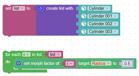

    #80405
    objects which have the same shapekeys and its a pain making a “set morph” puzzle for each and every item
    easy way

    #80409
    would still be nice to do it the “normal” way though
    the “normal” way will be exactly the same ))) they will just add a similar loop into the puzzle’s JS code…
