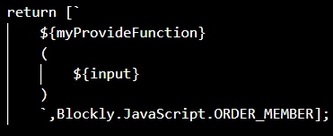

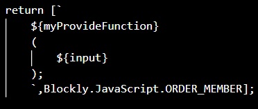

IMPORTANT EDIT!…
the SEMICOLON at the end of the parenthesis around the argument needs to NOT be there.
this is a project-breaker, and your puzzles’ return output will not be able to be plugged into a receiving puzzle.it should be like this…
(Notice the diff of the 2 images… NO semicolon.. )Attachments:
