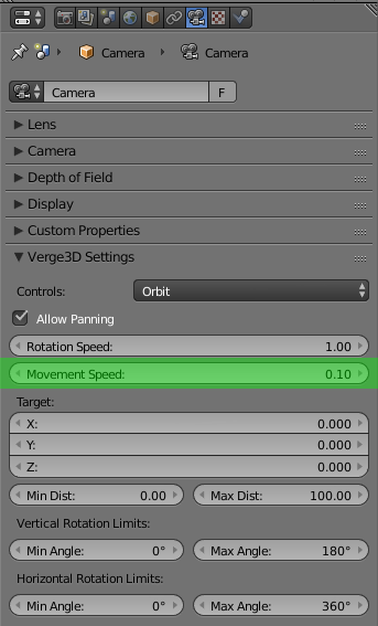

    I need to slow the pinch-zoom rate down
    You might want to tweak the movement speed setting for the camera. This setting affects zooming on touch screens among other things.

    PS: Already had the opportunity to test the camera moving speed tweak and things do improve concerning pinch-zoom behavior!
