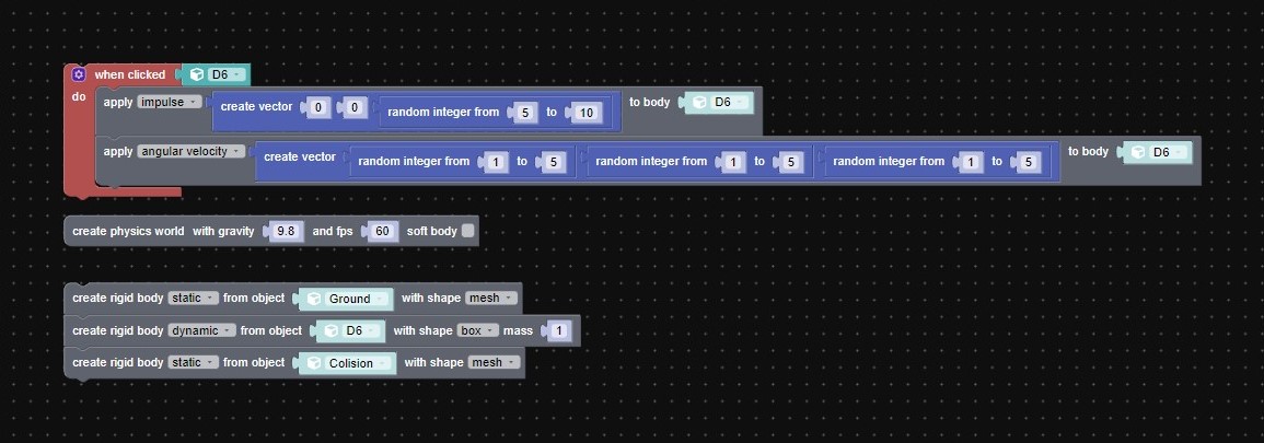

    Hi everyone!
    So I made an app for myself and some friends to roll some dice on game night.
    I’ll use this mostly on a tablet.
    You tap or click the dice D6 and with a impulse and some angular velocity it will go up and rotate a bit for a random roll.
    https://cdn.soft8soft.com/AROAJSY2GOEHMOFUVPIOE:376f112071/Dice/Dice.html
    My Issue is that the Physics work only for a few seconds and I can’t figure it out why.
    Any help would be appreciate it if you encountered something similar.

    Your dice becomes inactive when it stops moving. Make it active before applying an impulse.

    Oh wow!
    Thank you! It works now, really appreciate your help as I’m sure others here on the forums do.
