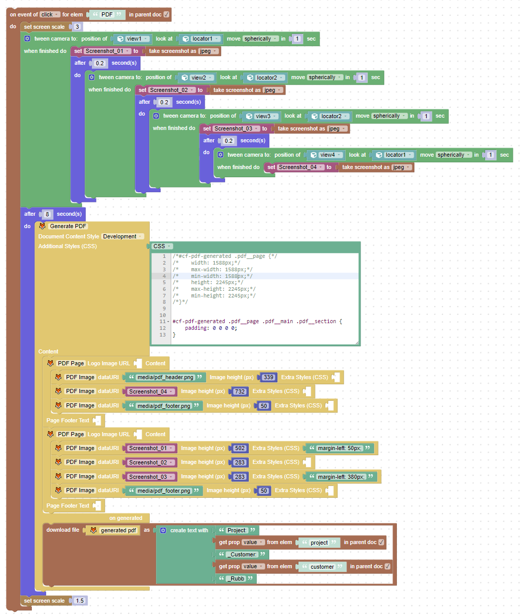

2023-08-08 at 1:34 pm #65883David Duperron
Customer@kdv77kdv It looks very promising, I’ve just bought the plugin (and two of yours!), but I can’t figure out how to change point of view and take several screenshots to add to my pdf.
The tween camera does not seem to work when used inside the generate pdf puzzle, even with the once finished option…
How did you achive this in your example??
ThanksDavid
2023-08-08 at 4:19 pm #65894kdv
ParticipantLook up and see the attached screenshot.
2023-08-08 at 4:46 pm #65896David Duperron
CustomerThank you so much! as usual the answer was already there…

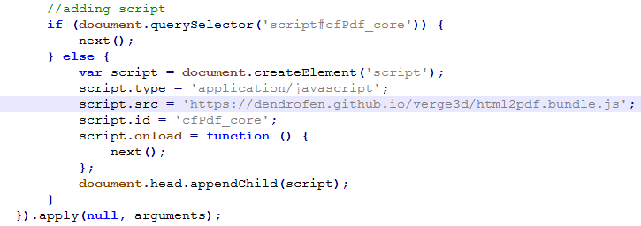

ParticipantLooks like now none of this plugin users can. The core script
html2pdf.bundle.jshas been deleted from there.Puzzles and JS coding. Fast and expensive.
2023-09-29 at 1:14 pm #67226brotchen
Participantlet’s hope the plugin is fixed. I sent an email to their support “info@cyber-fox.net”. Let’s see if I get an answer.
EDIT : It has been fixed! The script was reuploaded to the adress https://dendrofen.github.io/verge3d/html2pdf.bundle.js All is good!
2023-09-29 at 2:03 pm #67230kdv
ParticipantYou’d better save a local copy of this script to avoid surprises in the future.
2023-09-29 at 2:41 pm #67231brotchen
ParticipantI did, but with my limited skills, I couldn’t make the plugin work with just my html2pdf.bundle.js file in my app folder.
