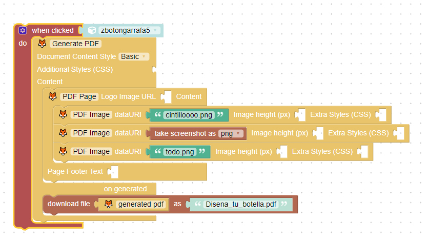

    #52142
    mtanous88
    Is there a way you could sen me a screenshot of your puzzle please?
    I am using V2.1

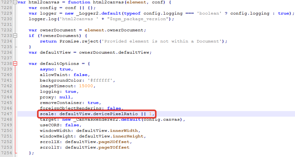

    The plugin has an issue. It changes a PDF page quality according to an HTML page scale or its pixel ratio (Ctrl +/-). But when the scale of an HTML page is 0.5 the result picture quality is two times better, the page resolution is two times higher. Now the plugin gives a better PDF page quality with a worse HTML page resolusion )))
    iOS Safari cannot download generated PDF files. Just ignores them.
    P.S. The plugin takes devicePixelRatio as the scale factor, but it’s a wrong way. devicePixelRatio isn’t a page scale. The real v3d canvas scale is 1 / devicePixelRatio Thus, the plagin takes low-res screenshots and generates PDF with a high scale (2 or more). On the contrary, in Google Chrome with devicePixelRatio 0.5 the plagin takes high-res screenshots and generates PDF with the scale 0.5 ))). Also the plugin ignores the actual v3d canvas resolution.

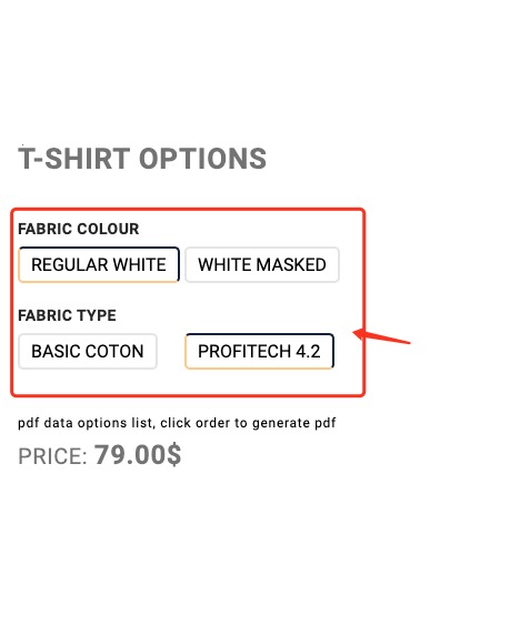

    yijin
    I found the parameter information of configuration(see the picutre)there is no in PDF.

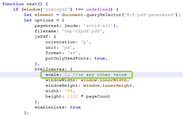

    How to increase the resolution or size of the document? As it is now it is not usable for commercial use at all.
    I’ve tried to adjust this in the css:
    #cf-pdf-generated .pdf__page {
        width: 795px;
        max-width: 795px;
        min-width: 795px;
        height: 1122.5px;
        max-height: 1122.5px;
        min-height: 1122.5px;
        box-sizing: border-box;
        background: #fff;
        display: flex;
        flex-direction: column;
    see attached pdf for an example of the result i am getting
    #63291
    Change the default page scale in html2pdf.bundle.js
    Or you can add the scale as an option in the cf_pdf() function which will override the default scale value
    As a result you can generate a high resolution PDF document
    https://v3d.net/a6h
