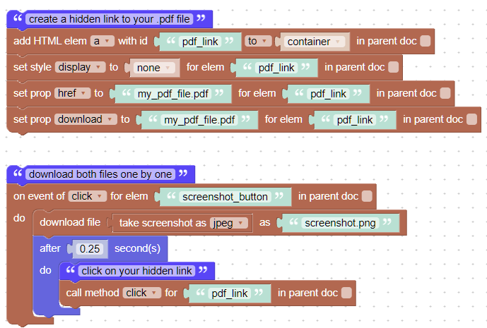

    Hey everyone,
    I have created a puzzle to capture/download a screenshot, but at the same time I want to download a .pdf guide which is in the applications folder.
    Is this possible or does anyone have an idea how I could solve this problem?
    Thank you very much
    Do you want to download two files one by one or you need to insert a screenshot into an already existing PDF file?
    #78001
    stefan.wisckow
    I want to download both files one by one.
    1. the screenshot
    2. the pdf file (it is in my application folder)
    #78012
    #78018
    stefan.wisckow
    You are a genius!
    it works perfectly.
