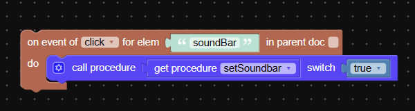

    When I call a procedure with an input, the input is undefined unless the call is in the same tab as the procedure. (see screenshot) can I call the procedure with an input, in another tab than the tab where the procedure is?

    There is a naming conflict between variable assigned by “call procedure” and the variable with the same name from the procedure in the different tab. We’ll need to figure out how to fix it, meanwhile you can easily resolve this by renaming some of your “switch” vars, e.g. to “s” or “switch in”.

    Thanks!
