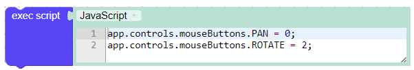

    In the Verge3d engine, the default is as follows:
    Left mouse button: orbital overview
    Right mouse button: move along the route.
    I need to do the opposite. To work like in this example:
    https://mega.ru/scheme/belaya_dacha/
    Is it possible to do this with puzzles? I’ve been trying to make puzzles for a week, but whatever I do I don’t get the desired result.
    Please help me.

    I am very grateful to you for trying to help, but I still couldn’t do it (
    I tried three activation options…
    Sorry, I’m still inexperienced, but I’m trying.
    Perhaps some other puzzle is needed for the script to work?
    #80441
    frans
    found my mistake!
    Thank you very much! I am a happy person! You made me happy!
    You are a good person, I shake your hand! :yahoo: :yahoo: :yahoo:

    it still doesn’t work the way I want it to on my phone
    it remaps only mouse buttons. and will do nothing for touch controls.
    #80445
    unfortunately for touch controls you have to completely override the OrbitControls class which requires some knowledge of JavaScript.
