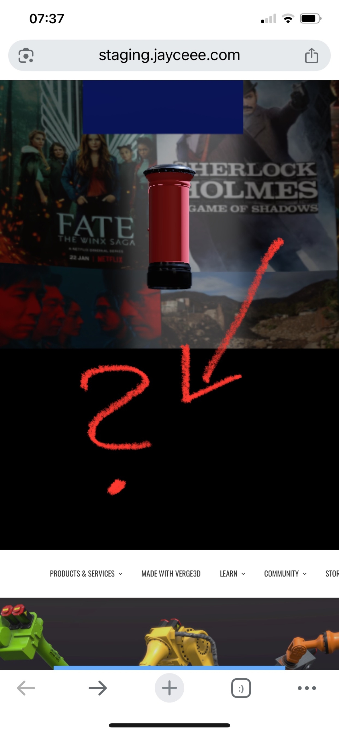

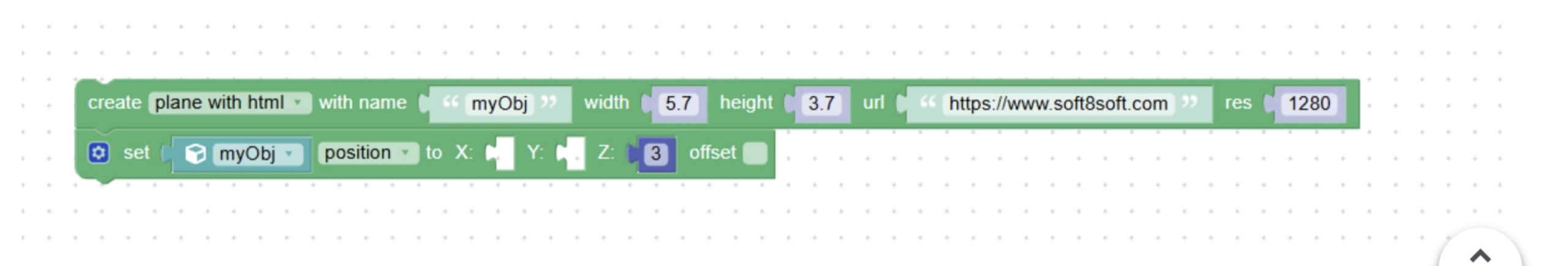

    Getting a funny offset, but only on mobile when I use the “create plane with html” puzzle , any ideas?
    https://staging.jayceee.com/v-content/Jc3d/1000_Lp/1000_Lp.html
    #85237
    Strange thing, this reproduced only in Safari browser. Perhaps another browser bug… Unfortunately, I could not reproduce the same behavior if I move the camera the same way you do in your website. Perhaps there is some CSS-specific issue there. :unsure:
    As a workaround you might try scrolling the objects, not the camera in your scene.
