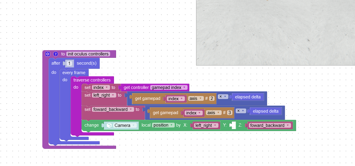

    Hi all! I am trying my best to get the Oculus Quest controllers to move the camera. I did the following but am at a loss. I don’t know where to begin but I am absolutely sure it can be done.
    I followed this guide as best as I could:
    Verge3D 3.1 for Blender Released
    #38431

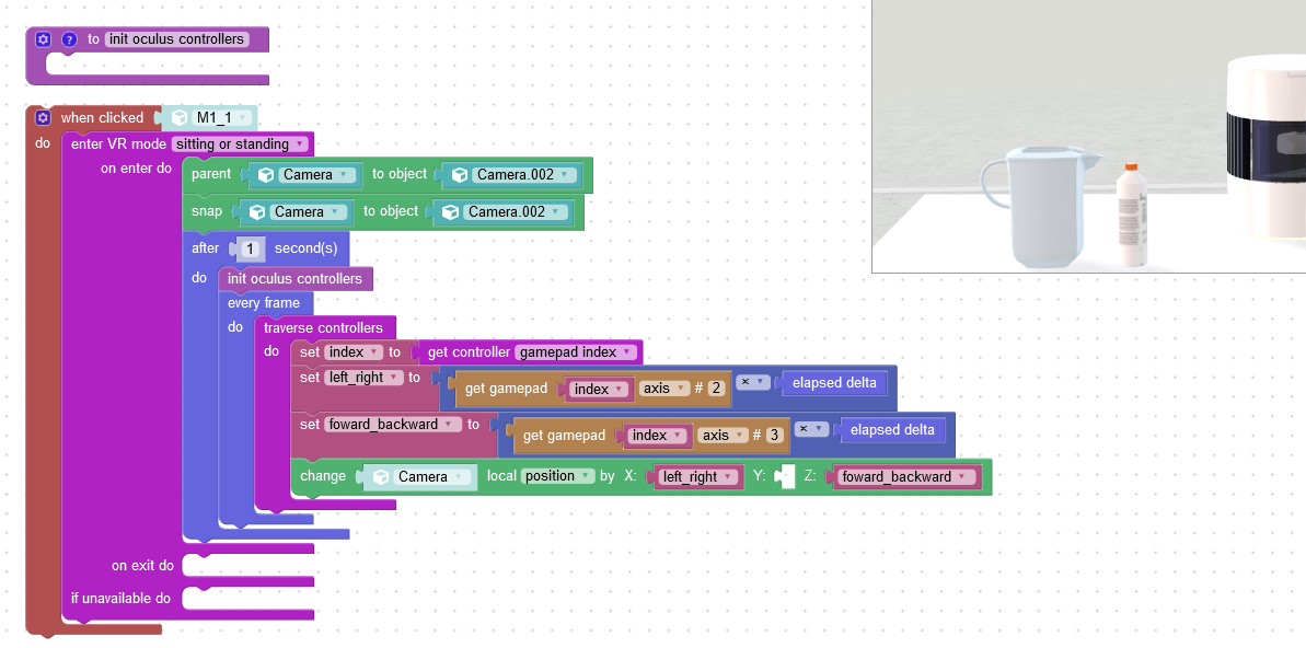

    ocularvr
    Just to answer myself here, and anyone else who wants to get the Oculus Quest thumb sticks as a movement input. The attached puzzle did it for me, the one thing I have not figured out is how to separate the controllers, like no “traverse controllers” in order to have more options. Any ideas would be really welcomed.
