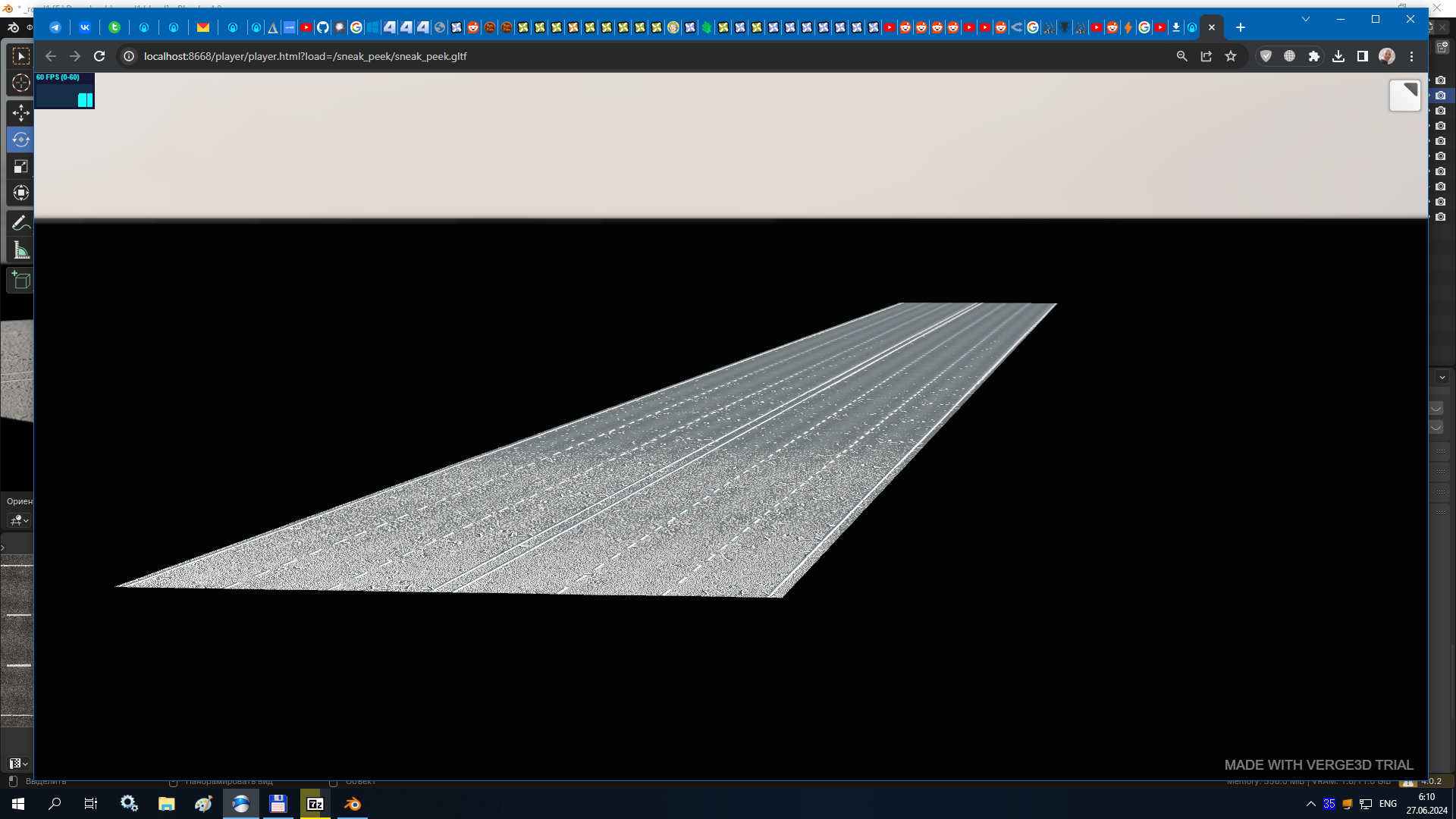

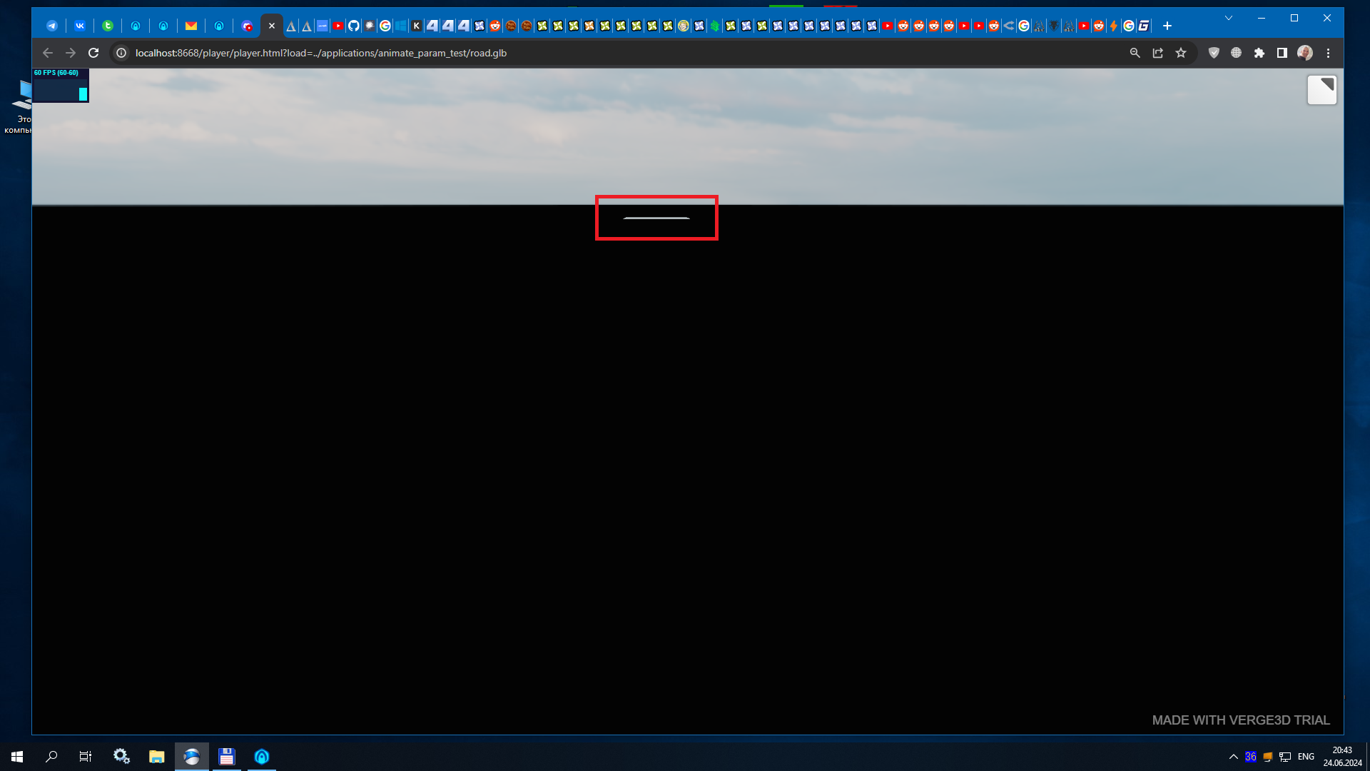

    #75544
    Everything is Ok with your plane. It’s visible and rendered with no problems. but it’s 125 meters away from the camera :scratch:

    #75612
    See no problems with rendering your road :unsure:

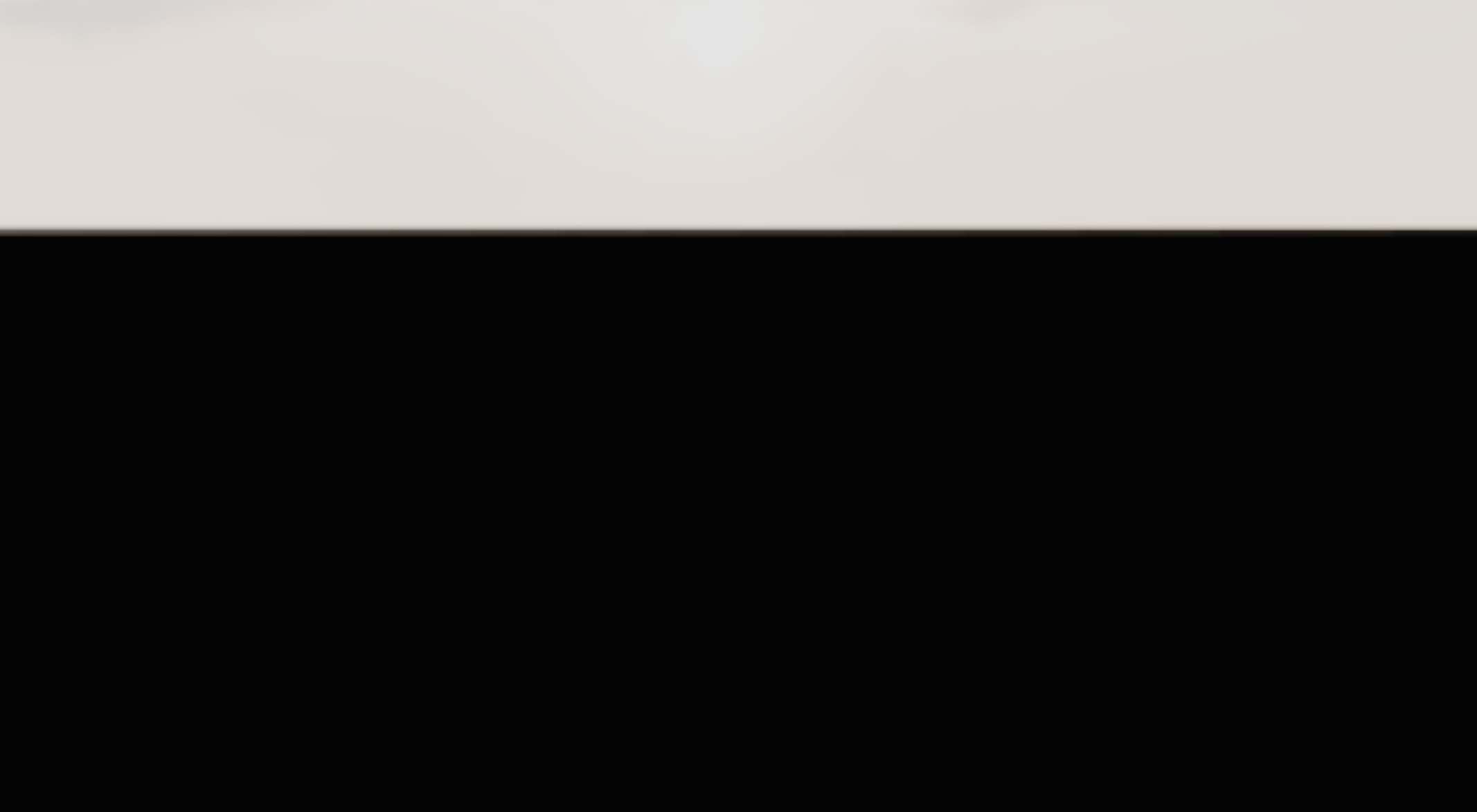

    #75614
    nils
    it’s wired, what i rendered out is blank.
    what’s the version of your blender?
    #75616
    tested in 4.0.2 with v3d.js 4.7.0
    Press F12 and see the log…
    #75694
    nils
    I tried with the same versions as yours, but failed again. here is the log:
    3d.WebGLProgram: shader error: 0 35715 false gl.getProgramInfoLog FRAGMENT shader texture image units count exceeds MAX_TEXTURE_IMAGE_UNITS(16)
    #75695
    Tested with v3d.js 4.7.0, 4.6.0, 4.5.1 and 4.5.0. No problems at all. 4.4.0 and earlier versions do not support Blender 4.0+
    Btw, the Displacement material input is not supported in Verge3D. The same with the Displacement node.
