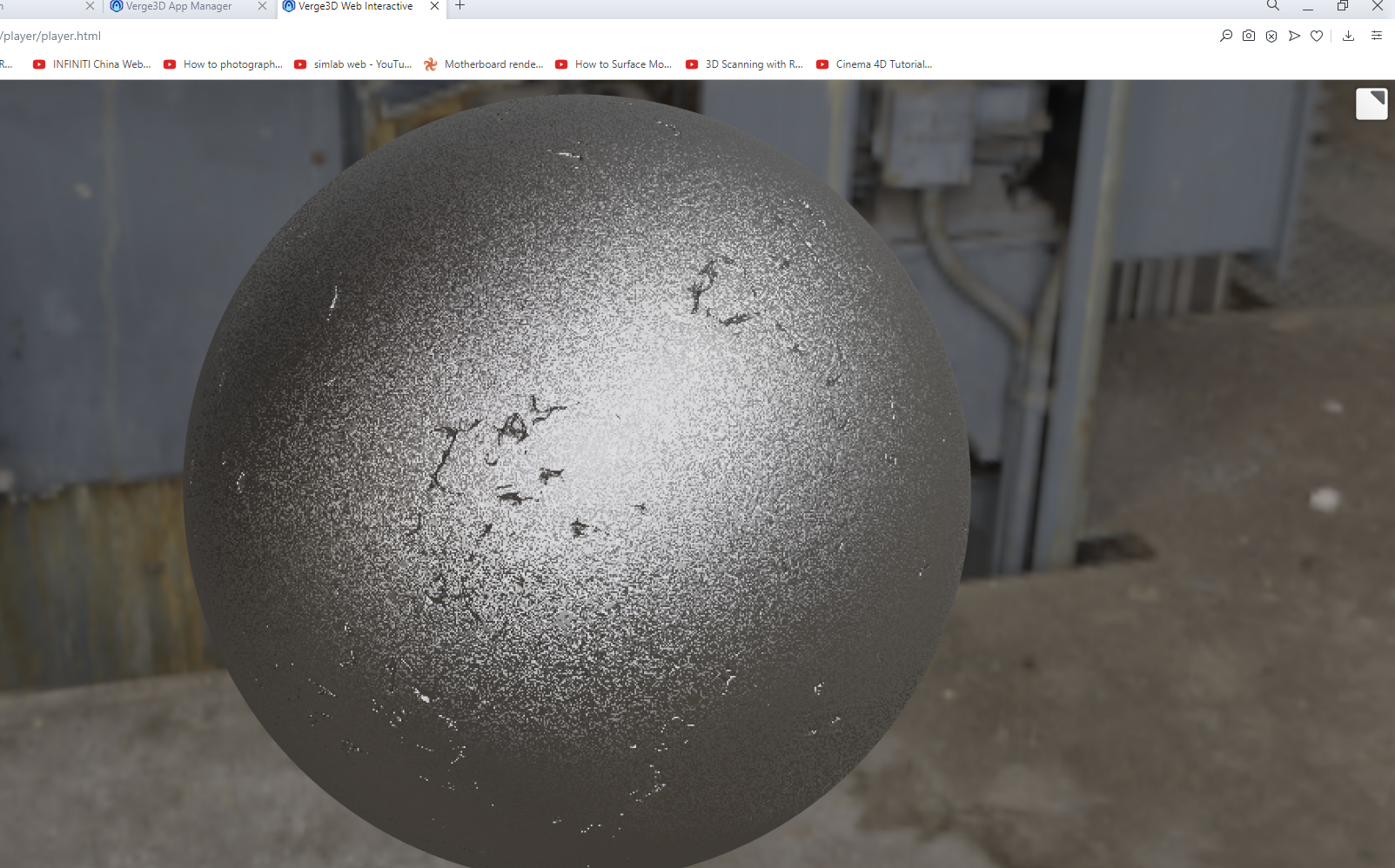

    The result I get on the blender is very good, but when I click Sneak peek, the result I get is very different. Can you help urgently?

    Do you use bump node?
    #40035
    ayyce1
    Yes, what could be the problem?
    #40302
    Problem is a bump node, try to bake all into normal maps.
