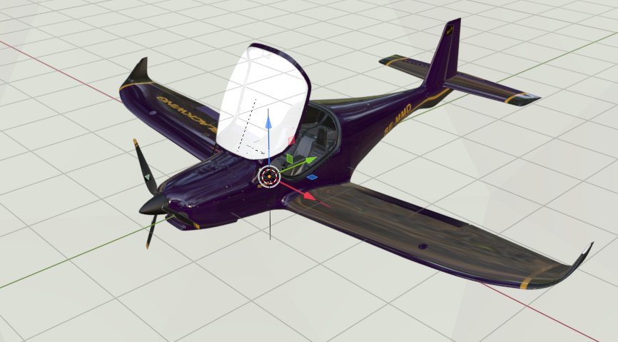

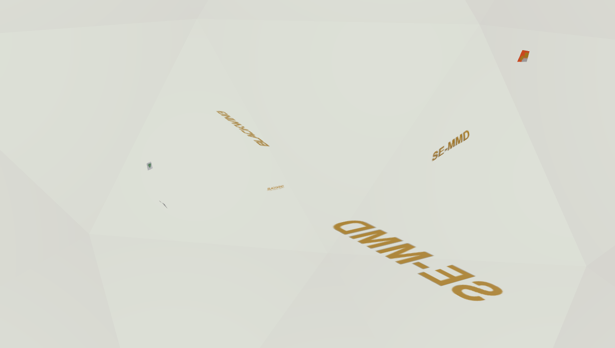

    I made some small changes in blender after a long time not working on my project and when i saved it, the 3D model dissapeared but the decals are still there, i tried reverting my changes but does not seem to work.
    What could be the issue?
    Thanks for any help.

    I would check a few things.
    1. Check that your normals are in the correct orientation.
    2. Since its been a while its possible some of the shader nodes that you are using are no longer compatible with V3D. Did you update either Blender or the V3D plugin?
    3. I would assign the plane a basic material and try exporting that and see if the mesh appears.
    4. Check that your material is not set to transparent (blended, clipped or hashed)
    5. Uncheck Optimize Mesh attributes in case the object is getting mucked up in the process.
    6. Make sure the collection you have the plane in is within one of the Collections that is being exported.
    #80043
    Most likely, shader errors. Press F12 in your browser and see the console log for details.
    #80049
    primaryd1
    Thank you for all the suggestions, I found out that Blender had updated but not Verge3D so that seems to fix the issue!
