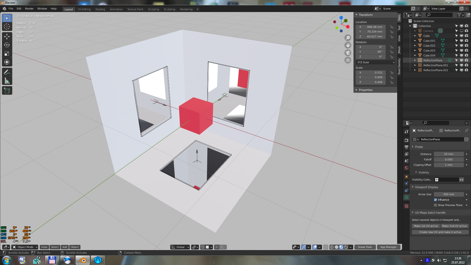

    Hi, I have an interior scene and i have two mirrors. They work perfect when only one reflection plane is activated, but not when I have both enabled.
    Is it possible to have two? They are not facing each other.
    Kind regards, Nick
    It’s possible to have more than two
    https://v3d.net/9kl

    This gives me hope. Still not sure what I have done wrong. Did you do anything special? I will have another play tonight.

    Nothing special. I’ve just added three cubes as mirrors and three reflection planes for them…

    I figured it out, they have to be separate objects, mine were joined.
