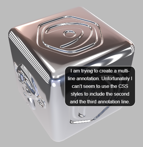

    Hi everybody,
    a quick question (please see the screenshot attached).
    I am trying to create a multi-line annotation. Unfortunately I can’t seem to use the CSS styles to include the second and the third annotation line. I want the second and the third line to be inside the bordered box of the first line, and not floating outside.
    Is there any workaround?
    Thanks in advance!

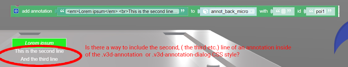

    praeluceo
    Hi Mikhail,
    thanks for the quick reply.
    I’ve tried to set the same styling for both “.v3d-annotation” and “.v3d-annotation-dialog”, but without any luck.
    .v3d-annotation {
    border-radius: 0px;
    background: rgba(0, 255, 0, 0.8);
    .v3d-annotation-dialog{
    border-radius: 0px;
    [you wrote “.v3d-dialog css”, though it isn’t described here:
    Styling Annotations
    so, is “.v3d-dialog” valid?]
    .v3d-dialog{
    border-radius: 0px;
    Is there any specific CSS I’m missing?
    Thanks a lot!

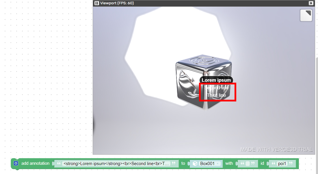

    praeluceo
    I’ll try to explain better what my problem is. Please have a look at the image attached. I’ve created a brand new project to demonstrate the problem.
    The code in the puzzle is:
    <strong>Lorem ipsum</strong><br>Second line<br>Third line
    The result is, that the second and third line are not within the style of the first line.
    Is there any way to style the second and the third line the same way as the first one?
    Thanks!
    #56161
    Read this once more. The second part.
    #56162
    praeluceo
    Me bad, figured it out -thx for your last example.
    I’ve been trying to put the whole text in the “annotation” field, which apparently doesn’t work – but inside the “with:” area the styling works. Thanks a lot again for help!
    #56163
    Well, it works if you assign width and height for an annotation name. See my first screenshot. But it’s better to use an annotation dialog to show long texts )))
