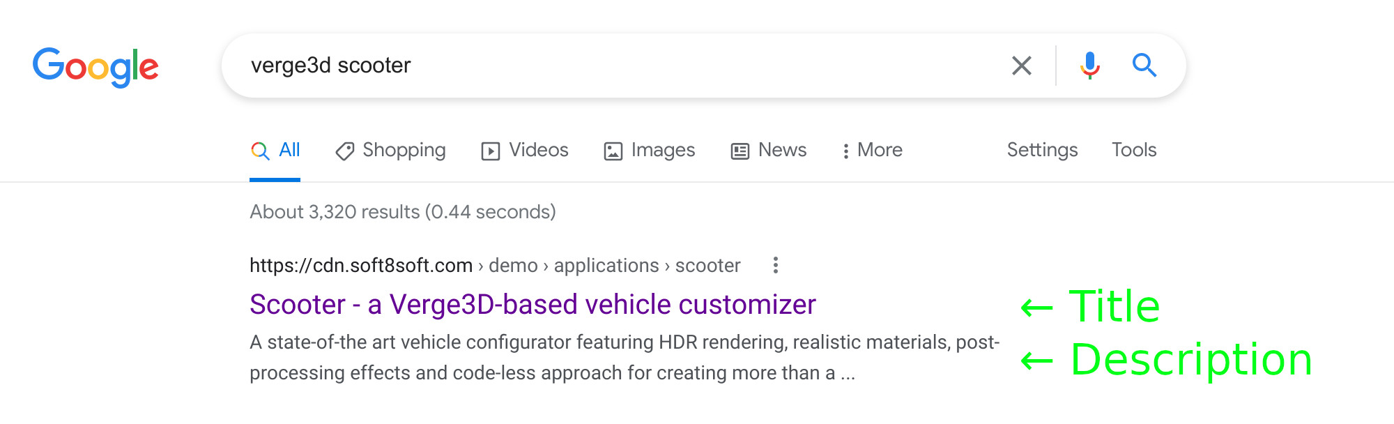

It's difficult to overestimate the importance of assigning meaningful title and description for your app.
The title is displayed in the browser tab and also used to bookmark your app link:
Both title and description are used by the search engines to find your app and present it to the user in the search output:
To assign app title change the corresponding setting in the application settings. Application description can be changed in the same manner.
Keep the length of the title below 50-60 characters. For description 120 to 160 characters is good enough.

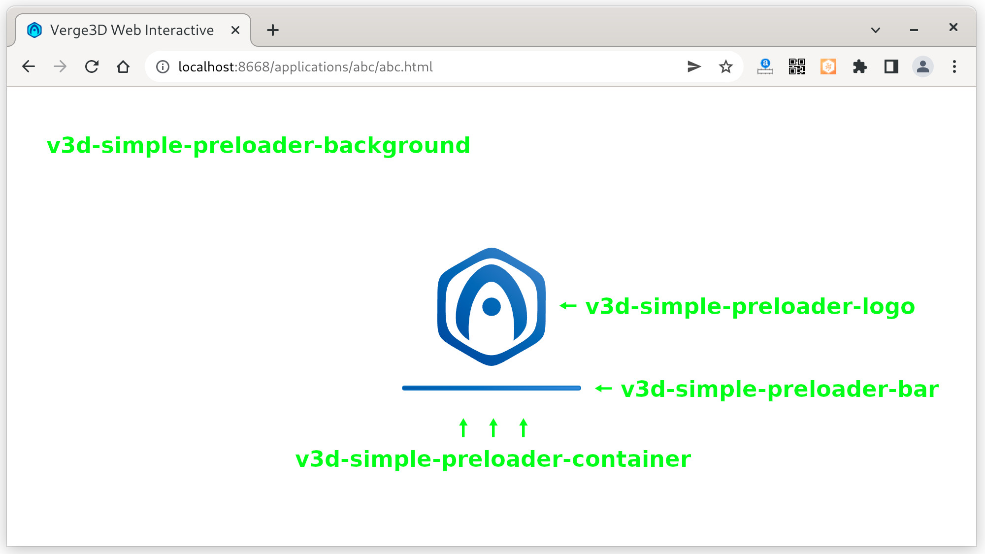

Customizing Preloader
To modify your preloader change the following CSS classes:
- v3d-simple-preloader-background — to customize the background of the entire preloader screen.
- v3d-simple-preloader-container — to modify the container element with the preloader image and bar. By overriding this class you can customize position and size of the preloader.
- v3d-simple-preloader-bar — to customize the loading bar.
- v3d-simple-preloader-logo — to customize the preloader image.

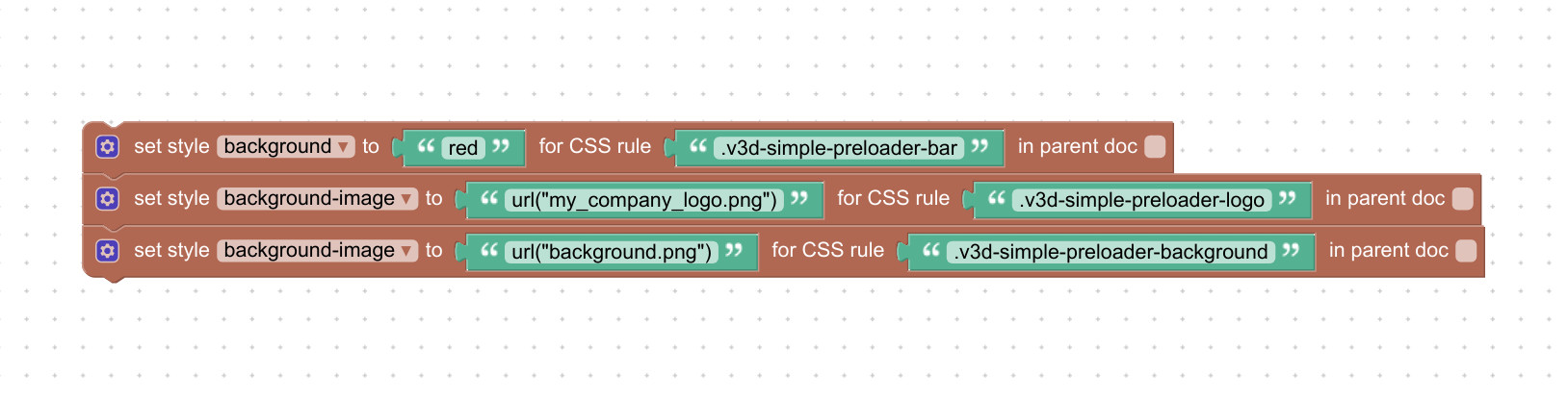

With Puzzles, all three style customizations will look as follows:
This snippet should be used in the init tab of the Puzzles editor because the preloader must be customized before the scene is loaded.

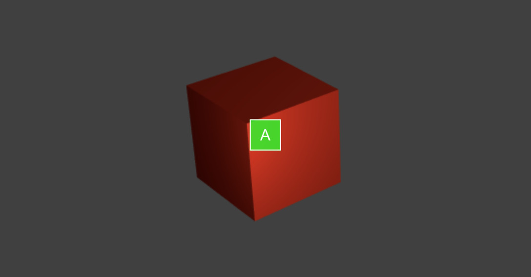

Styling Annotations
To style your annotations use the following CSS classes:
- v3d-annotation — for changing the style of the annotation icon.
- v3d-annotation-transparent — for changing the style of semi-transparent (occluded) annotations.
- v3d-annotation-dialog — for styling annotation popup dialog.
For example, to make your annotations square with green background:
.v3d-annotation {
border-radius: 0px;
background: rgba(0, 255, 0, 0.8);

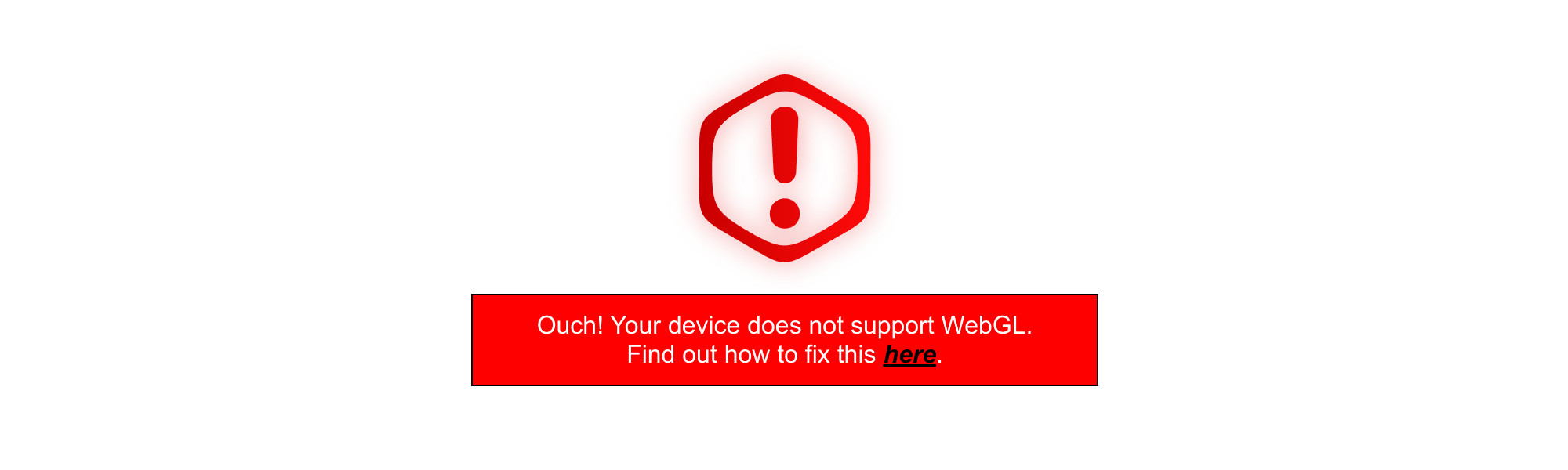

Customizing WebGL Error Screen
There are four CSS classes which define look of this error screen:
- v3d-webgl-error-container — for changing the style of the error container.
- v3d-webgl-error-image — for changing the image displayed above the error message.
- v3d-webgl-error — for changing the style of the message.
- v3d-webgl-error-link — for styling the error message link.
