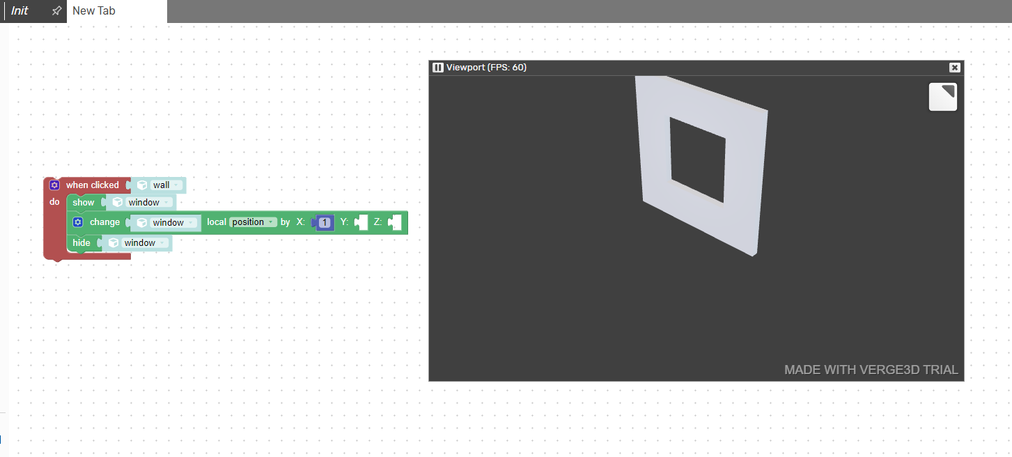

I am new to Verge 3D and Blender so finding my way at the moment. I wish to create a wall that has a window in it. In my application I wish to allow the user to click on arrows to amend the horizontal position of the window. As a simple test I have created a cube for the wall and another cube for the window in Blender and added a boolean difference modifier to the wall with the window as the target. I have not applied this modifier. If I hide the window from the Renderer then when I render in Blender I see the hole of the window.If I export the gltf file to Verge 3D I can see the hole too in the preview.
However if I set up a puzzle to move the window object, the hole does not move.
Can anyone help me resolve this issue so the hole moves when I adjust the position of the window object.

Mikhail LuzyaninStaffThis will not work in Verge3d because all modifiers baked on export. Better to to the same using shapekeys, just make the window in the wall and resize it as you need with shapekeys for example one shapekey for width another for height, another one for moving it horizontally or vertically and change the shapekeys using especial Set Morph puzzle. For more detail look at our Furniture video course on youtube.

the modifier itself won’t work in Verge3D but you can use the boolean operations puzzle with the same result.
