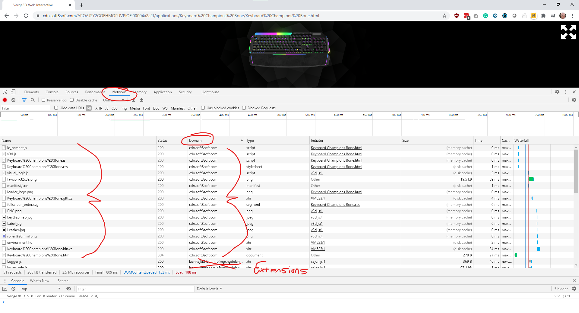

    #36142
    okay, and is there any way to check which files are being used in-app?
    because I don’t want to send an unnecessary file to the client
    like a blend file and backup etc

    Avatarjem
    Licensee
    @gurlaldeep singh, if you are ever in doubt about which files are used in the browser by a Verge3D scene, pop open Chrome dev tools and look at the network tab. Dev tools will show you which files are used by the scene.
    If you are like me and have browser extensions installed, there will be a lot of noise in the network tab. Sort the list by domain, and your files will be grouped.
