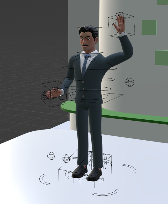

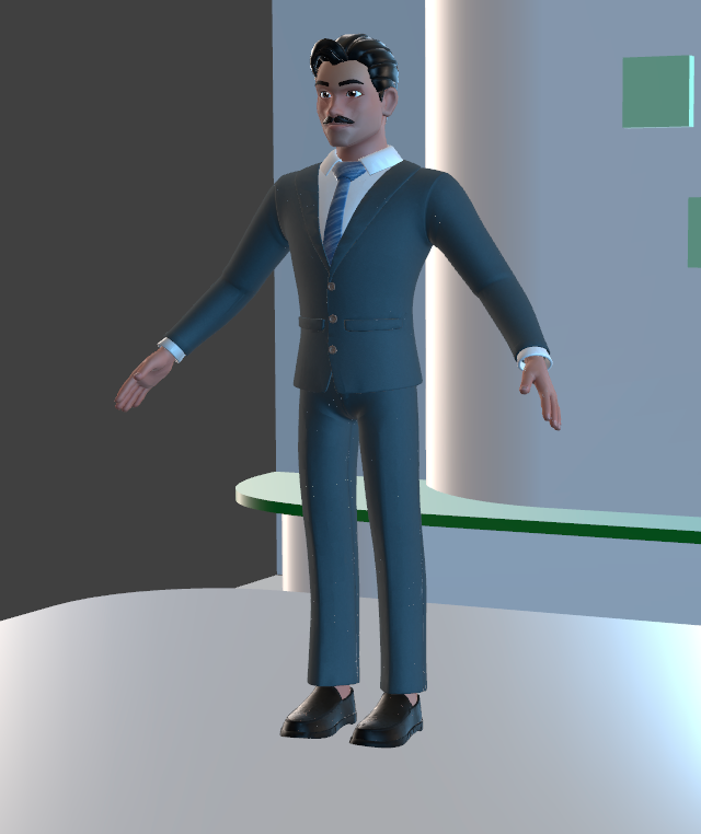

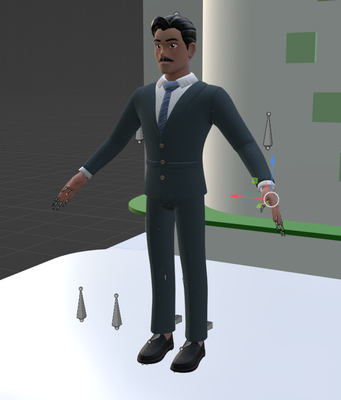

ParticipantI have a character that I used Mixamo to rig, any movement that I apply to the character doesnt show up in the gltf file in Verge viewer. Below are images to illustrate my issue. You can see the model changing poses in Blender but the pose doesnt show up in the Verge Viewer for the gltf file. The character instead allways get exported as it is in ‘Edit Mode’ as can be seen in the image with the bones. Any help would be appreciated.

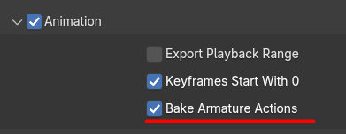

2025-02-13 at 2:45 pm #80226
Mikhail LuzyaninStaffIt’s because the animation made not on the deform bones but using IK and other constraints. To solve this just set Bake Armature Actions in the Verge3D settings on Render panel.
2025-02-13 at 3:34 pm #80230vergemo
ParticipantThis has solved it, I can see the change in verge gltf viewer. Thanks!

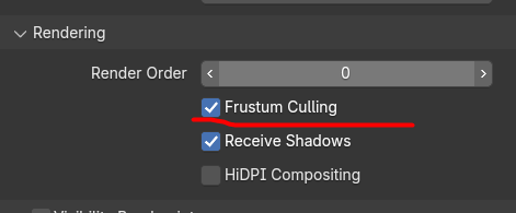

2025-02-17 at 9:21 am #80256
Mikhail LuzyaninStaffIt happens because the origin of the object far far away from camera because you move mesh using bones, just uset checkbox Frustrum calling in the object settings.
