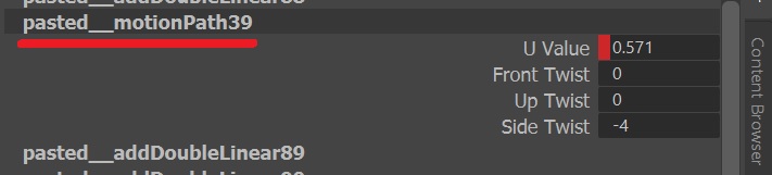

Nurgeldi DovletovStaffHi,
the “motion path” constraint is causing an animation issue, you have to bake its animation (spiral motion animation), not the animation of the constraint’s parameter.Attachments:
