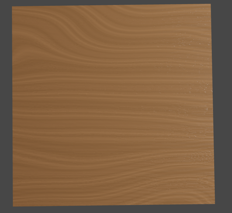

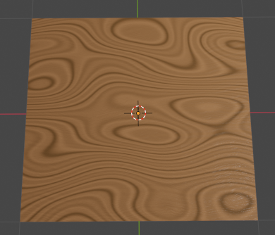

    Hello,
    I’m trying to create material wood. And on blender I get something similar to it but on Verge3d it skips some nodes.
    Is there any rules I should fallow when connecting multiple nodes?
    I notice that:
    * I can’t use Musgrave node.
    * I can’t connect noise texture and voronoi texture together.
    I can’t use image textures since I will scale my object so it would stretch.
    Can anyone help me solve this? :)

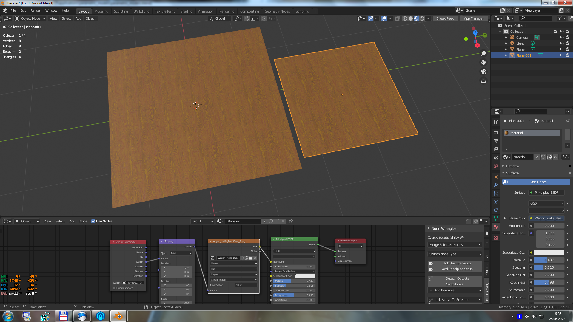

    You can. Create one more plane (or an empty object), use it as an Object in the Texture coordinate node and make it invisible. In this case you can scale your main object with no texture streching…
    You can also examine the demo app Parametric Models. But the materials there are more complicated than the one described above )))

    junglist
    Thank you very much.
    Completely solves my issue. :good:
