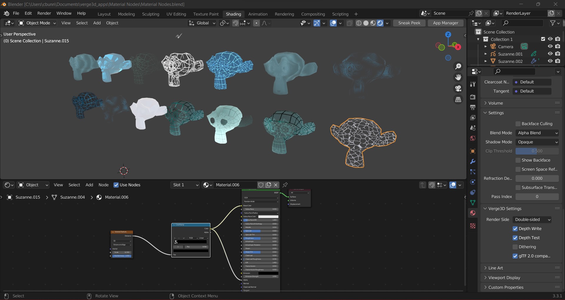

Thanks for getting back to me so quickly! I have tried both these methods with no luck. The simple BSDF/voronoi/colorramp combo just produces a white model as though it doesn’t have any texture, and recreating the same node setup in a new material looks a tiny bit different, but still has the same problems.
I’ve attached a couple of screenshots to show you what it looks like for me, in case you’re seeing something different.
Thanks again :)
2022-10-27 at 9:20 am #56900
kittCustomerI think I figured out the problem!!
Made the mistake of turning on the ‘glTF 2.0 compatible’ setting in the material tab – turning it off seems to make the material look much more like it’s supposed to!!
Ironic that trying to force a material to be glTF compatible makes it the exact opposite, but no matter – it’s fixed!!

ParticipantglTF 2.0 compatible
Yeap. This type of materials does not support nodes.
