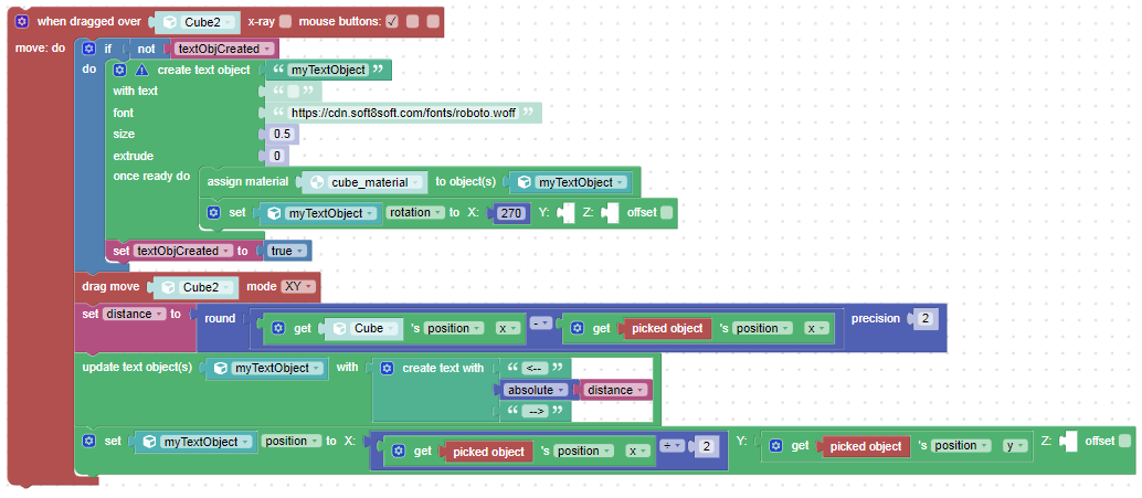

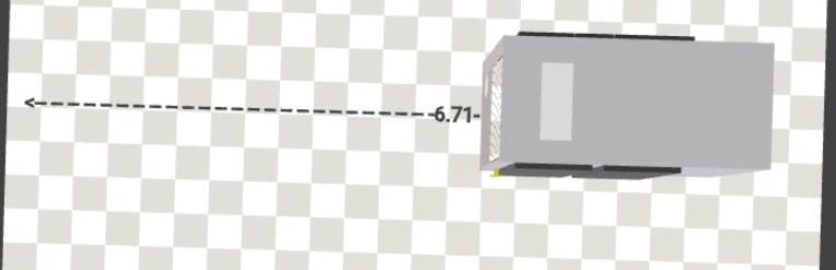

    I am trying to mark the dimensions of the equipment in the room from the wall i.e. Distance between wall to the equipment. I have created puzzle logic which create a text object near the equipment and provides the the distance from the wall. When the equipment dragged the text object should change dynamically and provide accurate distance from the wall. But the values created are lagging and not accurate. Is there any other way to do it effectively ??? or any changes which I can make in puzzles do it effectively…

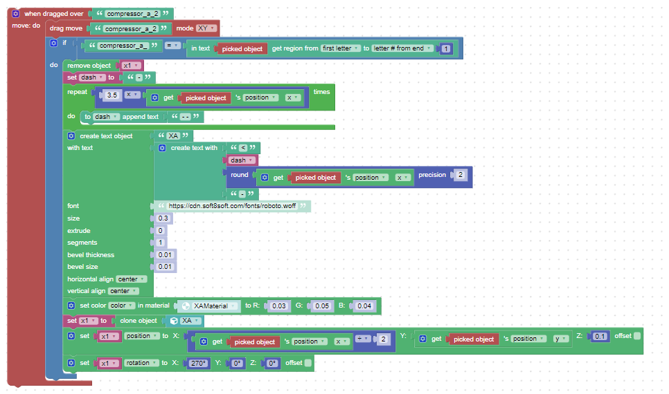

    use the update text object(s) puzzle instead of creating/removing text object every move (create your text object only once). that will remove lags. and re-check your math logic. and keep in mind, that this calculated distance is between origins…
    somithing like this
