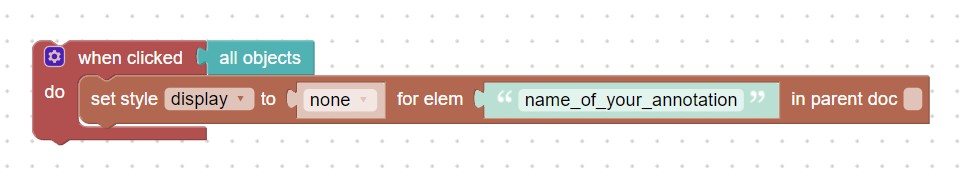

Mikhail LuzyaninStaffYou need manually hide them on click on any of the object on your scene like this.
Instead of the “name_of_your_annotation” put ID of your annotation or the list of ID’s.Attachments:

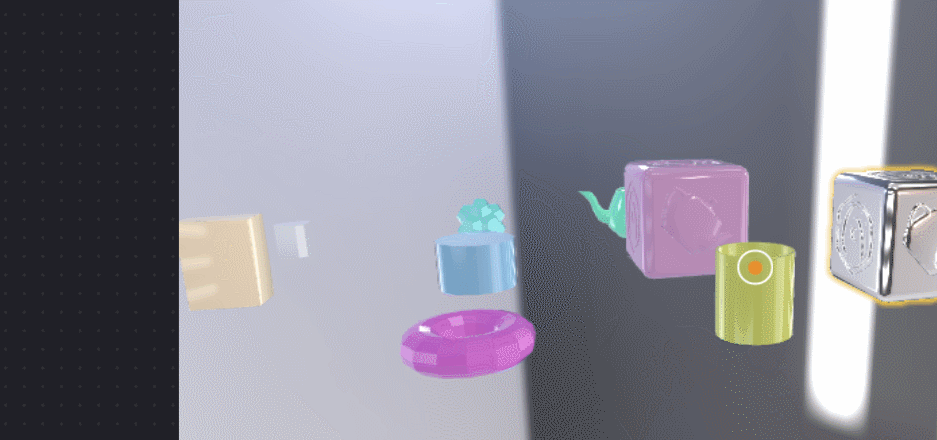

but, does it have to be apply on click? I’m trying to do it exactly like the orange button (.gif attached); change color and unclickable when obscured by other object (in my case make it not hoverable).
i’m thinking, if it’s possible to know if an object is in front of the camera or not (hidden behind other object), i can just change the style property by using the logic puzzle. is it possible with the puzzle?

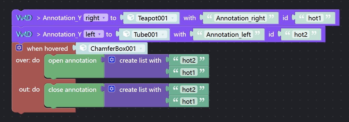

QiangGeParticipantOnly plugin puzzles
2024-09-10 at 1:20 pm #77293
geeCustomerOnly plugin puzzles
perfect! this is exactly what i want to do!
may i ask where do you get the first two puzzles? the purple ones. do i need to make a custom div like in this post ?
thank you so much for responding by the way, been stuck with this for weeks now..
2024-10-25 at 3:09 pm #78119
QiangGeParticipantHi gee , Today I posted this completed plugin on the forum and Gumroad. If you are interested, you can check it out. Thank you
