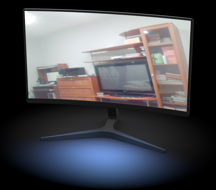

    is it possible to stream a video (from a connected webcam) into a verge scene as a video texture? if so, how?
    #63353
    https://cdn.soft8soft.com/demo/examples/index.html?q=webc#webgl_materials_video_webcam
    #63377
    auriea
    okay, interesting. using the video texture example project though, any way to swap an existing texture for a live webcam video? I’m guessing not, since you point to a full code example.
    let me just say it would be cool if there was a puzzle for this….
    #63378
    For now the only suitable puzzle is exec script. It’s possible to implement practically any code example in a standard Verge3D app. Depends on how badly you need it.
