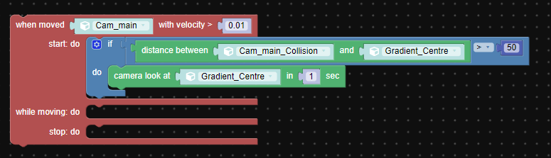

    #43994
    Jack Seymour
    Sure. I agree, ideally the camera would hold its focus point and just not be allowed to move any further.
    Attached are two very simple ways I’ve restriced movement of the camera without using contraints in blender. Both examples will lose the focus of the camera without changing where the camera is looking at when they occur. For my application this works well enough.
    The reason why I include the physics version is because it will allow you to define a more complicated boundary with a mesh. I made a collision object for the camera and then parented it to it but not sure if this is necessary.
    https://discord.gg/vGMAAED
    plz share Discord link & on your signature!
