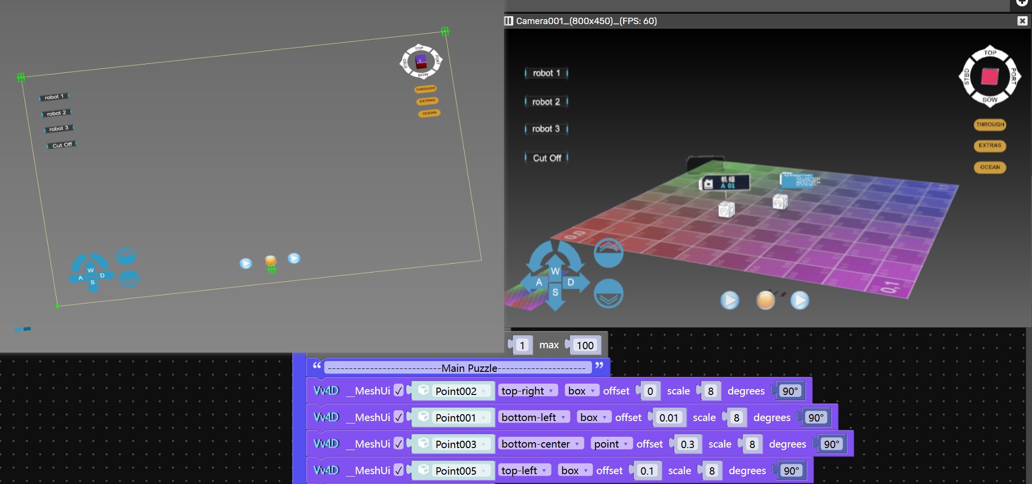

QiangGeParticipantAfter testing, using the “MeshBasicMaterial” method made it very simple to solve. That is, in 3ds Max’s glTF material extension panel, just check the “Unlit” option.
