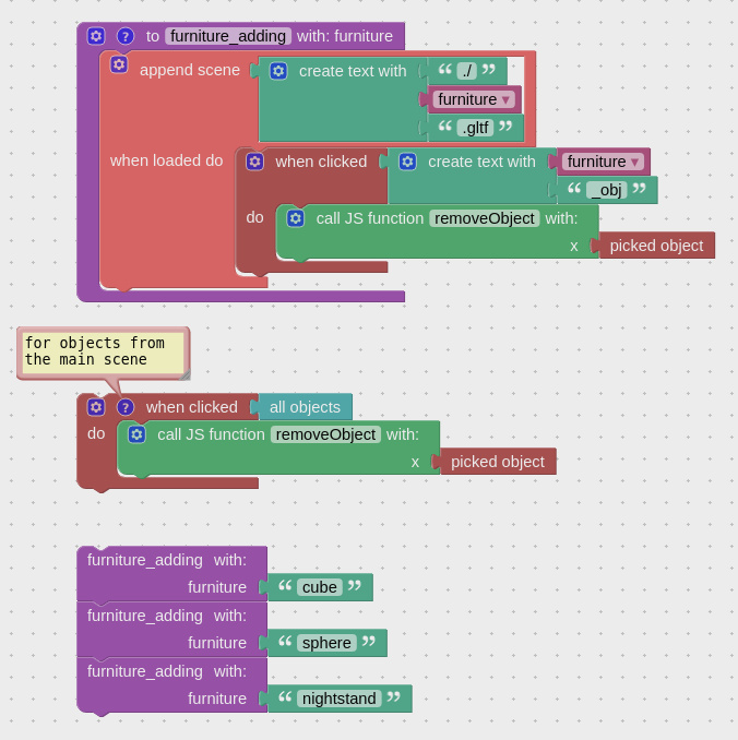

    I am trying to apply a JS function to objects from appended scenes. But it seems to not working, only with object of the original scene.
    Here is the JS function example:
    app.ExternalInterface.removeObject = function(objName) {
    var obj = app.scene.getObjectByName(objName);
    app.scene.remove(obj);
    And attached a picture of the puzzle example.
    I am sure it is no big deal to do this, but I can’t :wacko: … Any help would great.

    you can use the puzzles when clicked – all object only once. Also does it work for one-scene case (when you don’t use append scene)?

    Thanks Yuri for helping. It does work for a one scene only case.
    Only issue for objects from appended scene (with the when clicked – all object puzzle out of the procedure to not repeat).

    Dynamically loaded objects are added in sub-scenes parented to the main scene. So the code will be slightly different:
            obj.parent.remove(obj);
    P.S. I think we need a remove object puzzle.

    Thanks a lot! Working great. Indeed, I think a remove puzzle would be a great addition.
