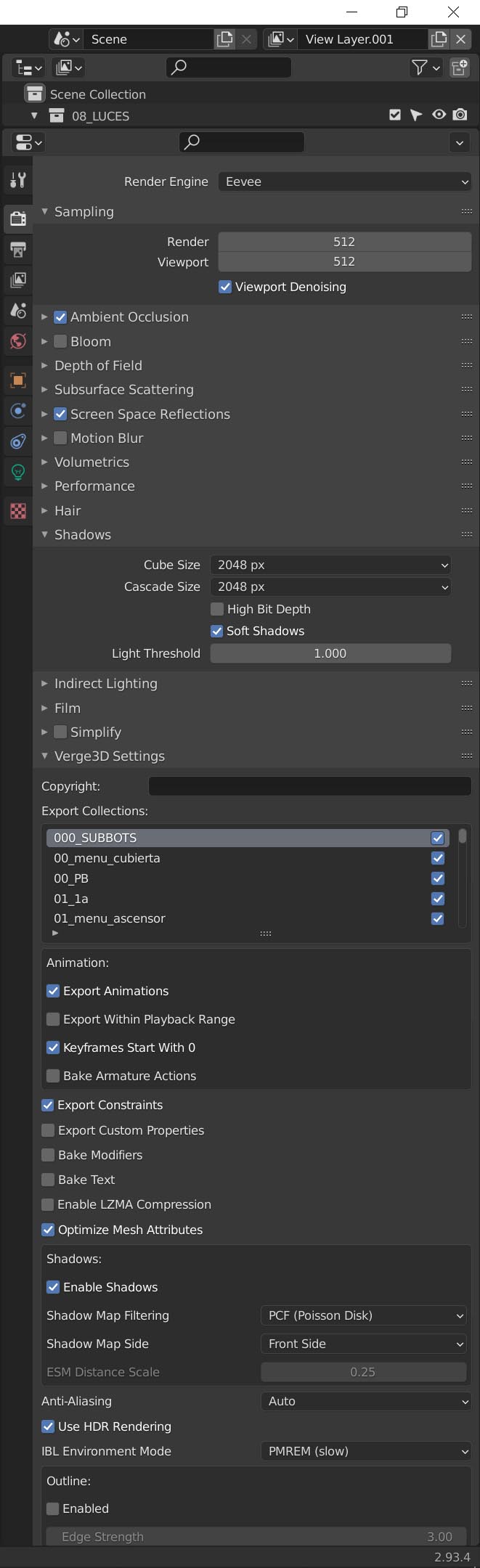

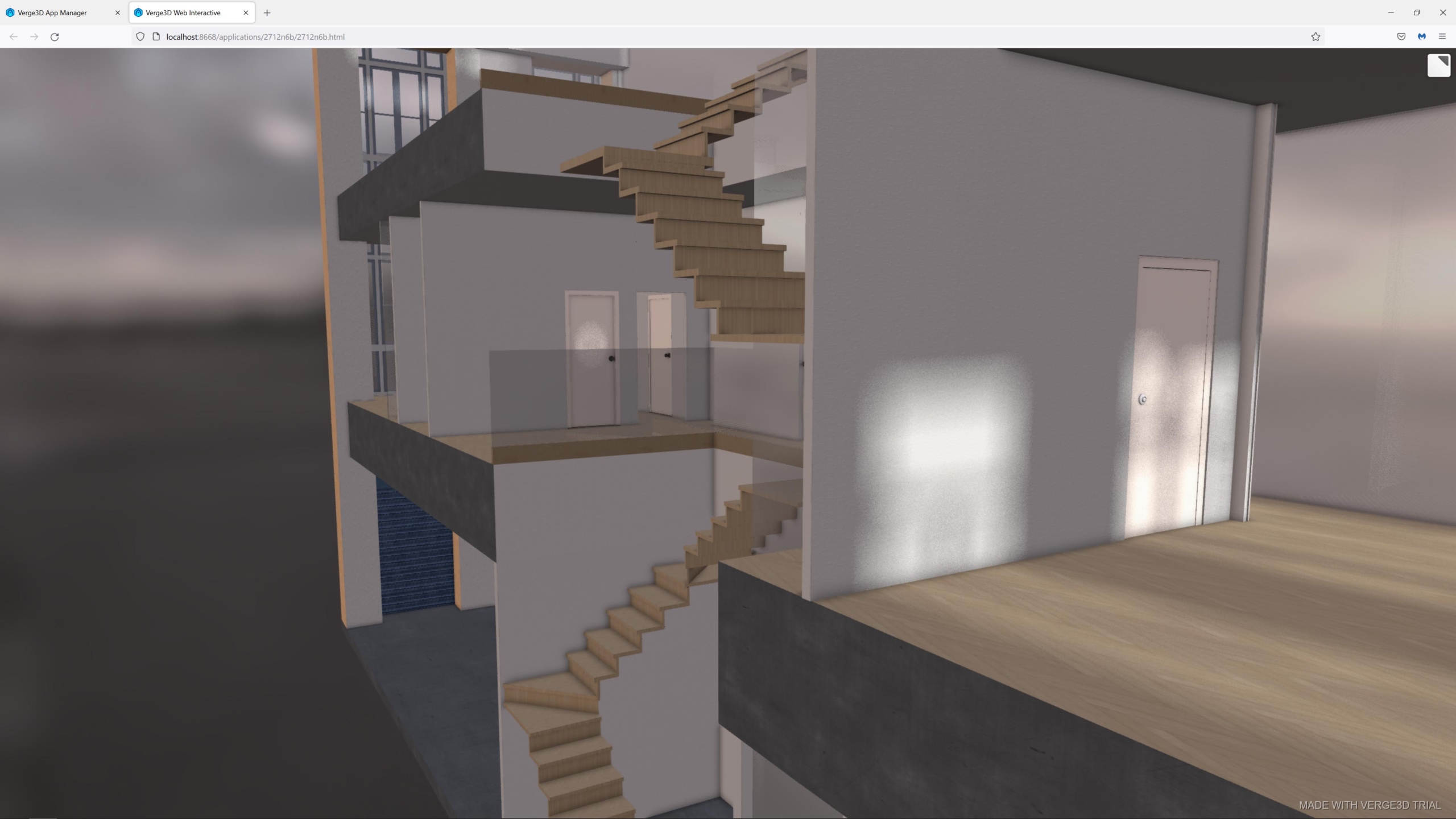

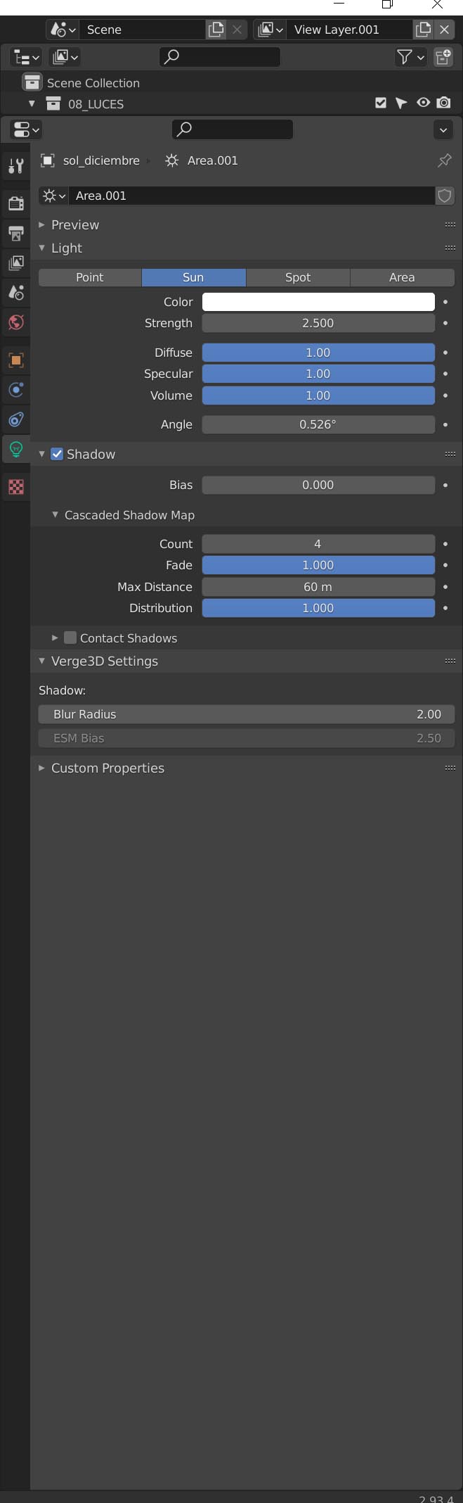

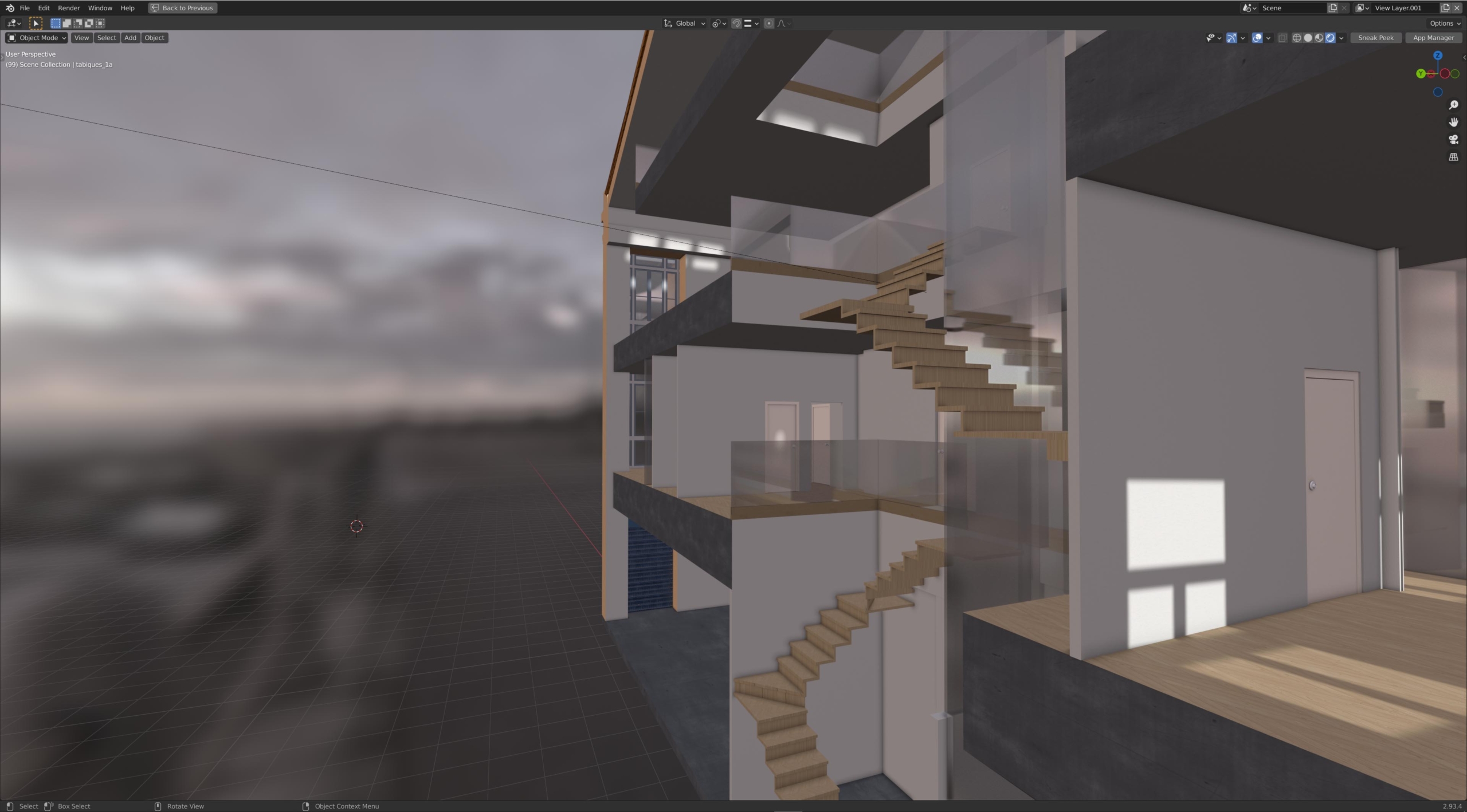

    I am having issues with Sun Lamp generated shadows with Verger3D 3.8 for Blender.
    Attached files show of how it looks in Blender and how it does in Verge3D ( with 1024 and 4096 Cube and Cascade shadow maps).
    The las two images show Eevee Render Properties and Sun Light settings.

    I finally figured where my problem came from: the quality of the shadows depends on the “Max Distance” parameter of the “Cascaded Shadow Map” of my sun light in Blender: the longer I set this distance, the more jagged shadows look at a close distance. My apologies for blaming it on the v3dFechaHora 3.81 version.

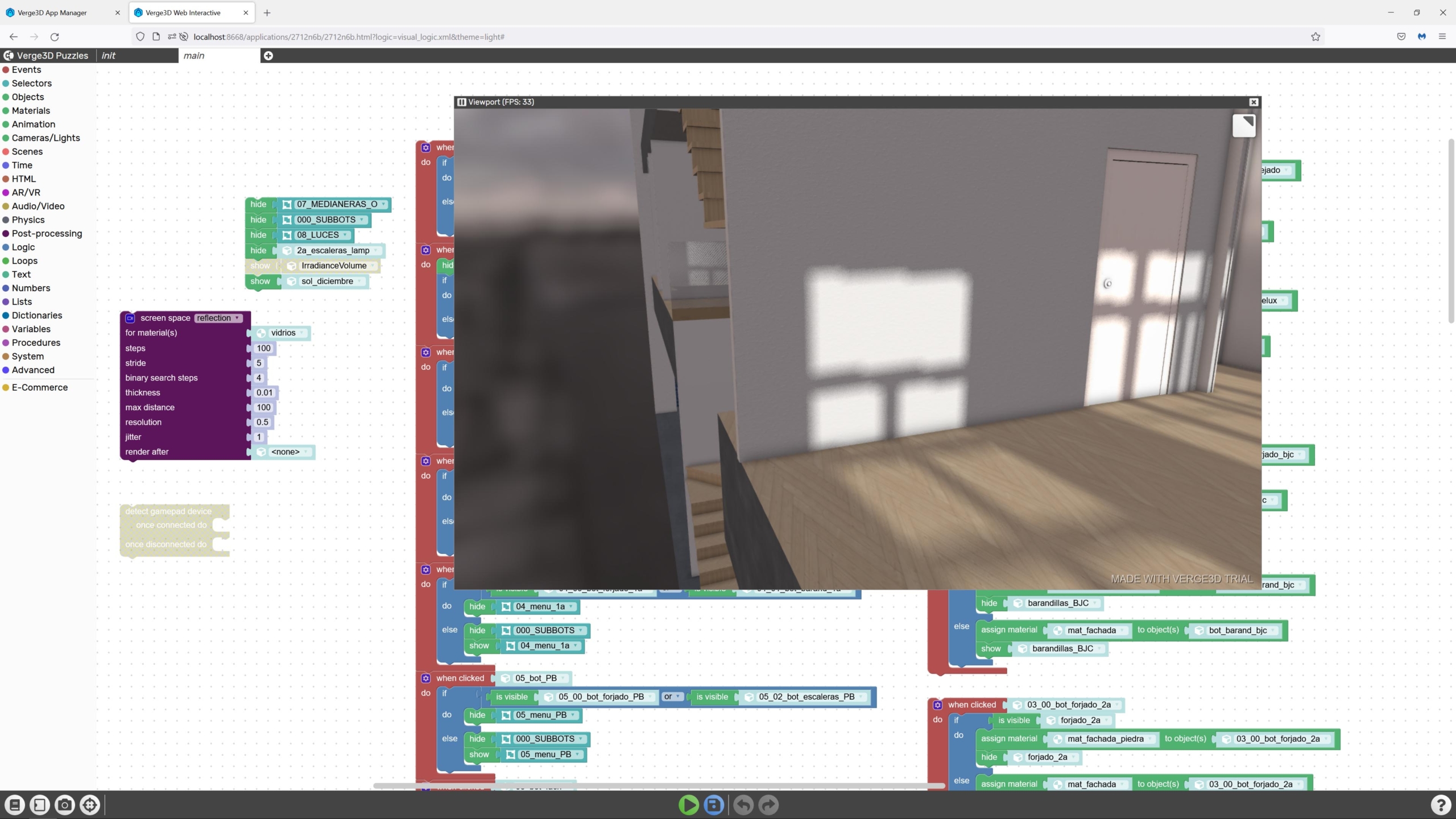

    The thing is that I wanted to have shadows visible both at long and close distances, so I found a workaround: on a “when moved active camera -> while moving” event I run a script to measure the distance betweem the camera and the center of the scene and update the “Camera.shadow.maxDistance” accordingly.
    I am still not sure that is the best solution or not, but it works for me at no apparent performance cost.
