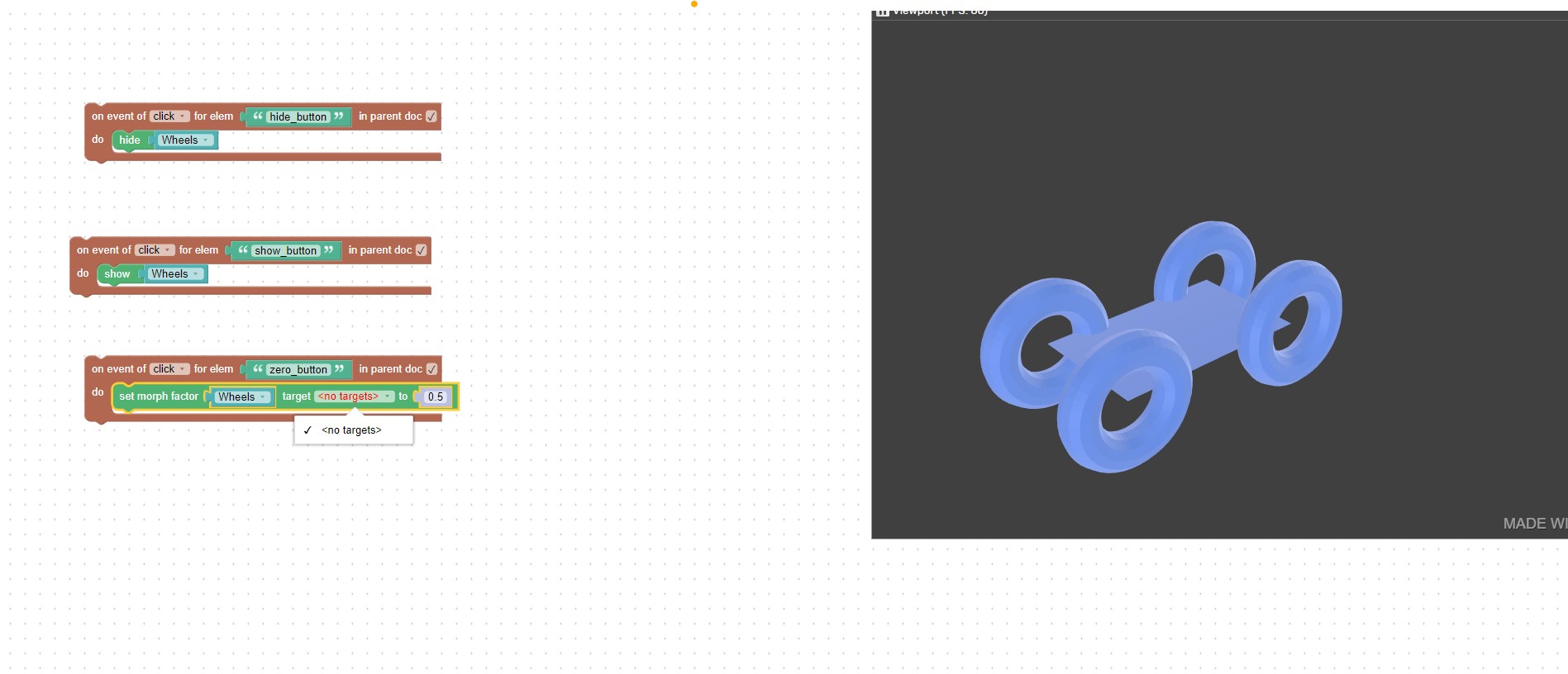

    I am trying to make test app with some basic logic behind:

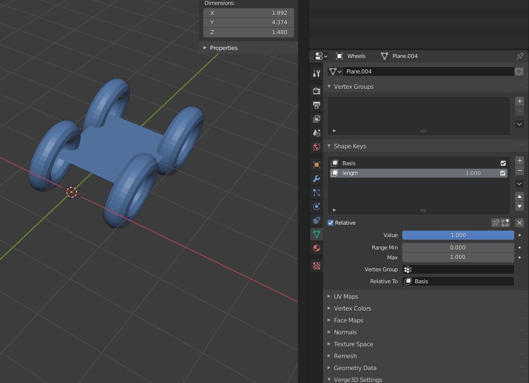

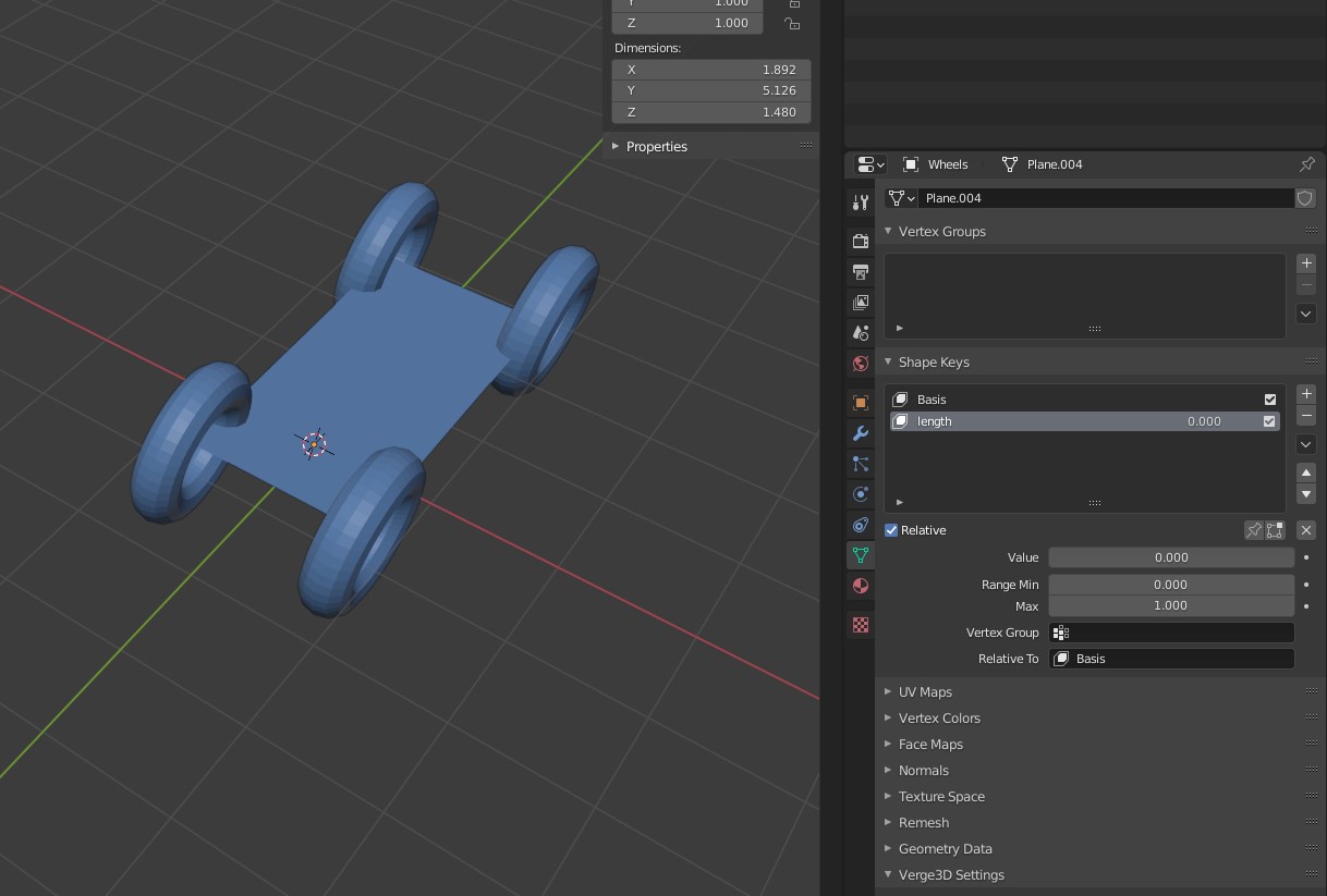

    I have model with single shape key – as shown on picture “long” and “short”.
    But when I go to puzzles and try to choose it as shape key noting is shown (picture “issue”).
    Anyone have idea why ?

    #33546
    You’ve got a mirror modifier on the object, it’s break a shapekeys. Shapekey not working with any modifier on export, because even if you try to apply it in Blender you can’t do this.
    #33547
    lukaszexeon
    Ok, it works now.
    Thanks a lot !
