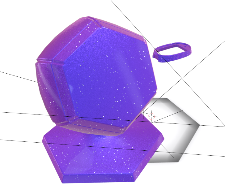

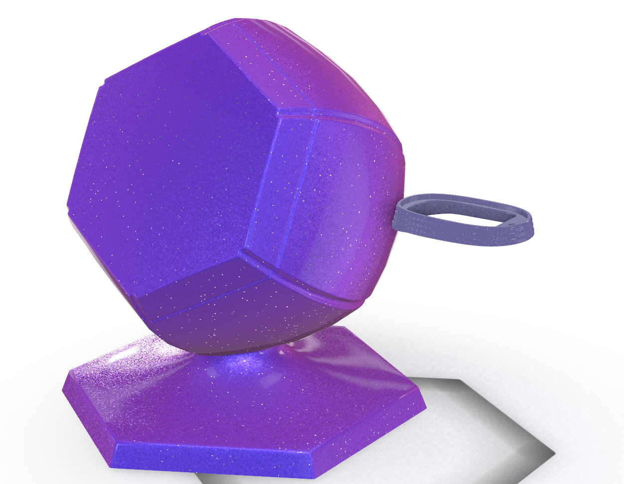

    I just got the Essentials material pack and am having issues with the color on my model vs on the sample model.
    What should i look at for the issue?
    It shows up correctly in the blender render view.

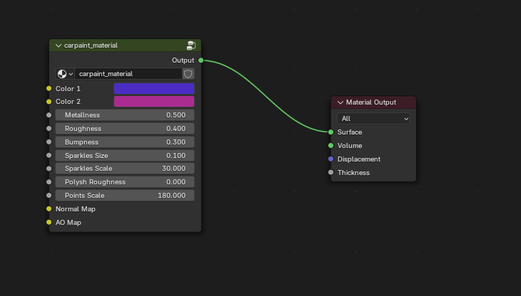

    Please provide the picture of the material nodes and values.
    #79247
    dmon86
    See attached, it is direct from the material pack with no changes
    #79249
    looks like it’s ok with the shader. Can you share a blender file with this piece of the mesh.

    It’s an issue with the engine, not the material, hope we can fix it soon, but for now just add a dummy UVMap on the mesh to fix this.
