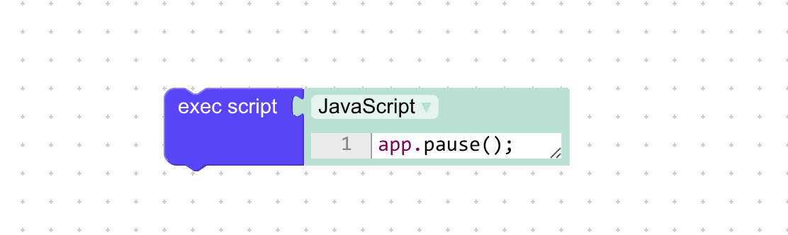

    #82899
    You can just pause the rendering once the app is loaded with this simple puzzle:
    puzzle to pause rendering
    #82925
    adamabr
    Thank you! That is great news.
