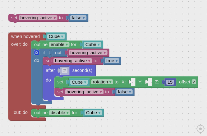

    I have the puzzles as in the attached picture.
    The problem is that the “over: do” part is like a switch. If the mouse is one time over the object the do part is executed. I want the do part executed after the mouse is hovering two seconds over the object.
    How can I do this? :unsure:

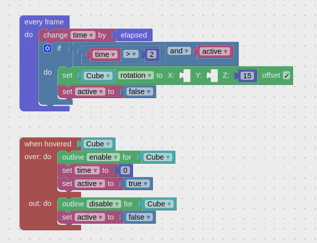

    Your example should work. The only thing you might want to add is additional checking to prevent multiple timeout events.
    Here is an example:
    #9635
    Clemens
    Hi Yuri,
    thanks for your reply, but it´s still not what I want.
    Perhaps I was to unclear. I need followinf behavior:
    1) Hover for MINIMUM 2 seconds over the object –> move camera
    2) Hover shorter than 2 seconds over the object –> do nothing (exit “when hoverer” puzzle)
    #9639
    I was able to achieve this in the following way:
