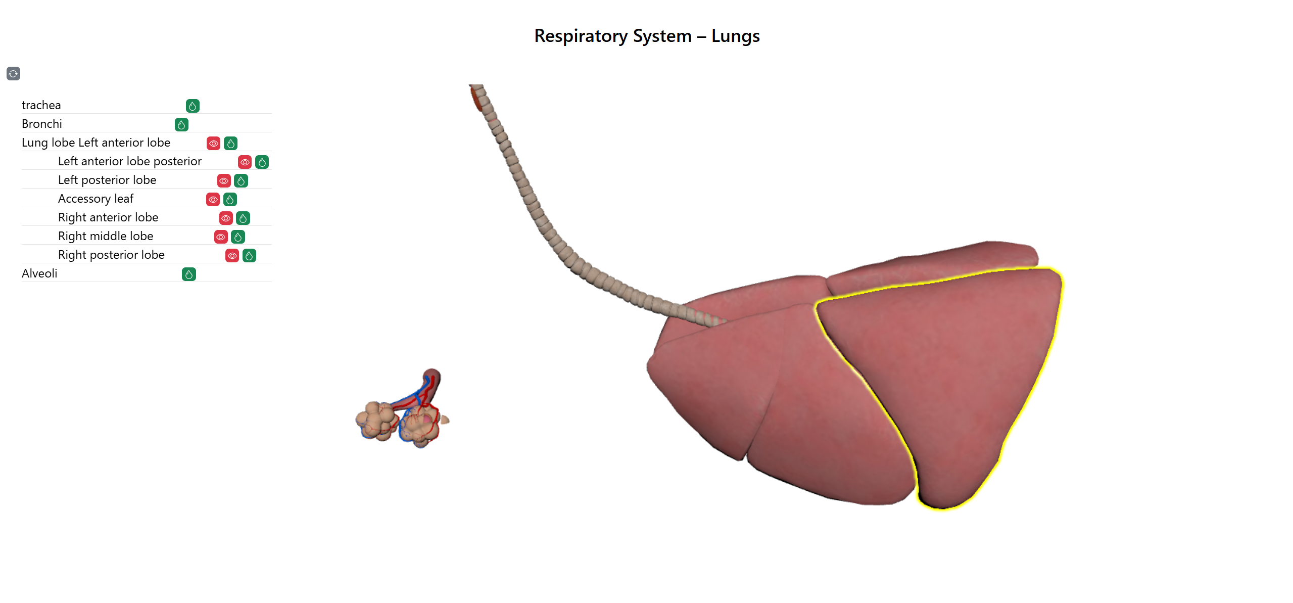

    Is it possible in Verge3D to automatically move a 3D model to the center of the screen?
    Below is an image from a sample I created.
    In the sample screen, there is a menu bar on the left side, where the red button toggles visibility, and the green button toggles highlighting.
    When pressing the green button for the “left posterior lobe,” the 3D model of the “left posterior lobe” is highlighted as shown.
    I would like to set it so that pressing the highlight button for the “left posterior lobe” both displays the highlight and automatically moves the camera to center on this model.
    Could you let me know if Verge3D has this capability?

    Hi habnet,
    Sure, you can use this puzzle for centering on an object.
    #78548
    This puzzle will also do the job (without zoomming).
    #78558

    I tried “look at”, but the 3D model disappeared.
    “zoom camera to object” works better, but is it possible to zoom in from a specified angle?
