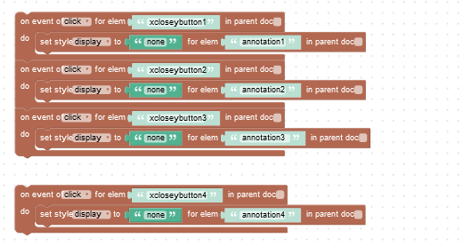

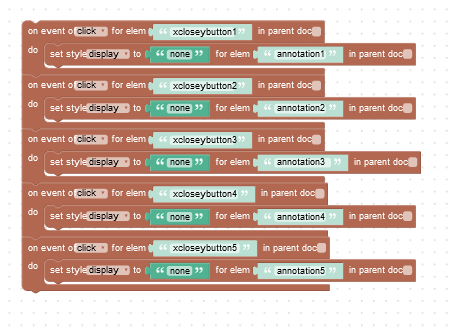

ocularvrCustomerI have an issue today with HTML Events in Puzzles. I have a system with 10 annotations – When I make the HTML event click for the element, all goes well up to 4 puzzles, its when I add a 4th that things go strange. Please look at the images.
NotOK = When I connect the puzzles I cant catch the 4th X in my annotations.
OK = When I disconnect the 4th one, the X is picked up and it closes as expected
My issue is that 5-10 do not work even with this trick. I looked closely at this and it seems that connecting and disconnecting the puzzle is behind what going on. I am completely blind on this one, please help!

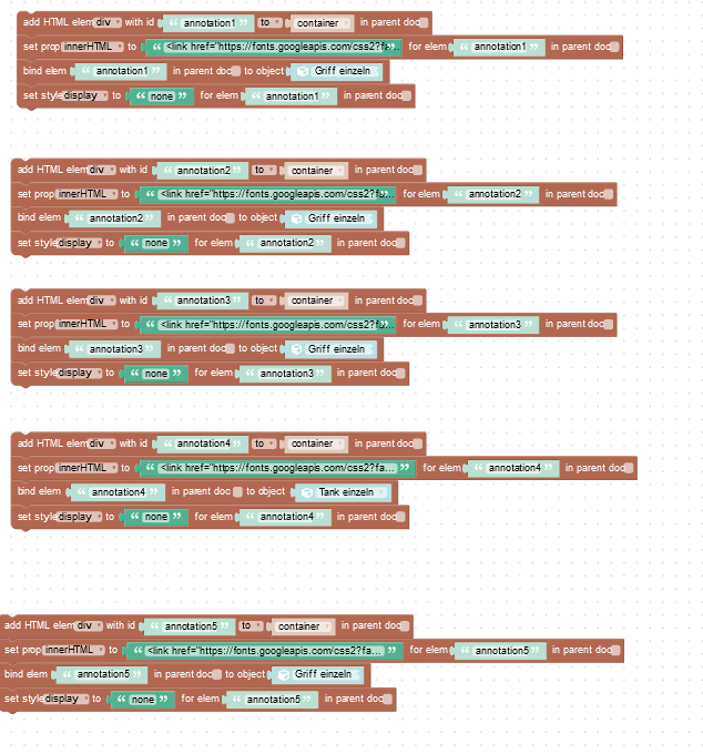

Here is the annotation (5):
<link href="https://fonts.googleapis.com/css2?family=Poppins&display=swap" rel="stylesheet"> <div style=" background-color: rgba(0, 0, 0, 0.6); width:100px; height:150px; border: 2px solid #a1c037; border-radius: 25px; font-family: 'Poppins', sans-serif; font-size: 12px; font-weight: thin; color: white; padding: 5px; text-align: center;"> <button id="xcloseybutton5"style="float:right; border-radius: 25px;"">×</button> <br><div style="border-radius: 25px; background-color: rgba(0, 0, 0, 1);"> <b> Step 5</b></div> Look at best practices in documentation</div>2021-02-18 at 10:40 am #38681

ocularvrCustomerAll annotation ids are unique, they are:
id=”xcloseybutton1″
id=”xcloseybutton2″
id=”xcloseybutton3″
id=”xcloseybutton4″
id=”xcloseybutton5″
id=”xcloseybutton6″
id=”xcloseybutton7″
id=”xcloseybutton8″
id=”xcloseybutton9″
id=”xcloseybutton10″I triple checked :)
In the worst case scenarios I could just think of some other way of serving the annotations although I really like the close on X idea
