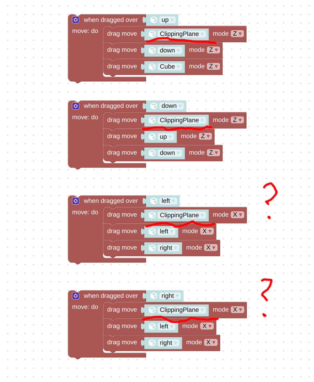

    Is there any way to cross-section an object in three ways? What to do from the top, from the right, and from the back? I’m trying to but can not do this. I’m using clipping planes. It’s working in one direction, but I need clipping planes in 3 directions. Like up and down, left and right, back, and front side.
    It works only up-down direction.

    #48764
    hi,
    I checked your puzzles. You are using the same clipping plane for moving in 2 directions. Should not it be 2 different planes?

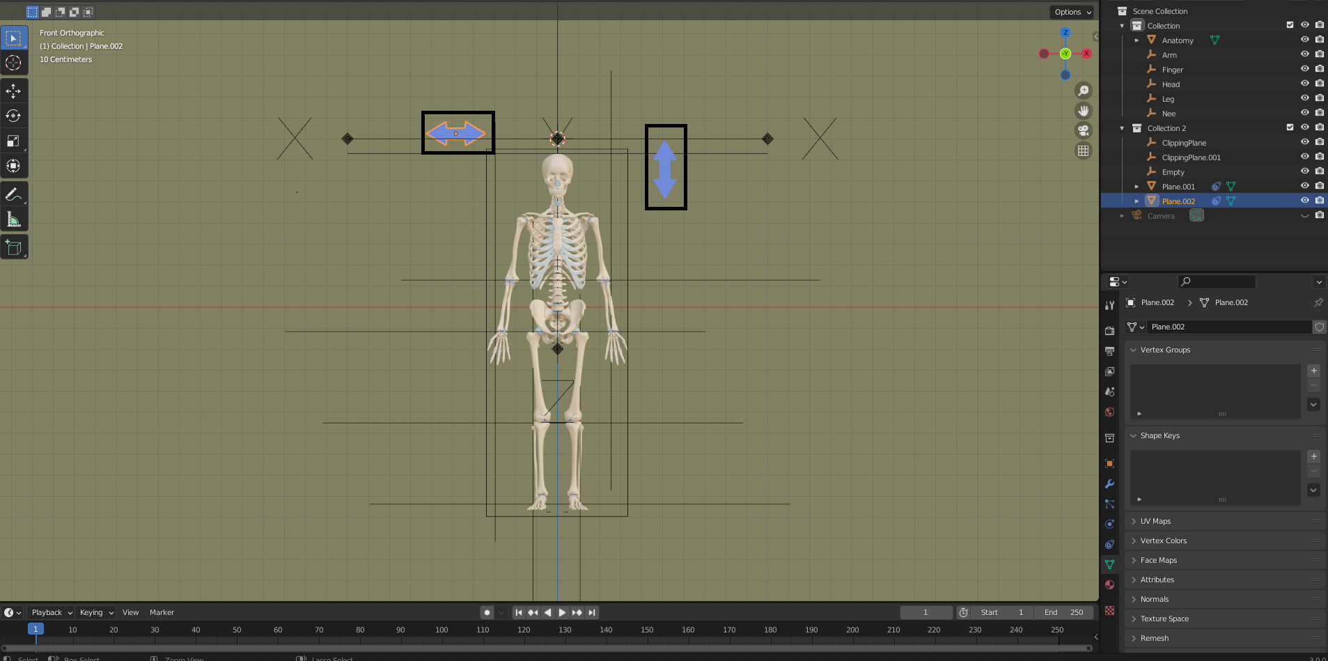

    Here’s an example for you.
    #48772
    mashud008
    Thank you, everyone. It’s working now. Just changing the clipping plane direction
