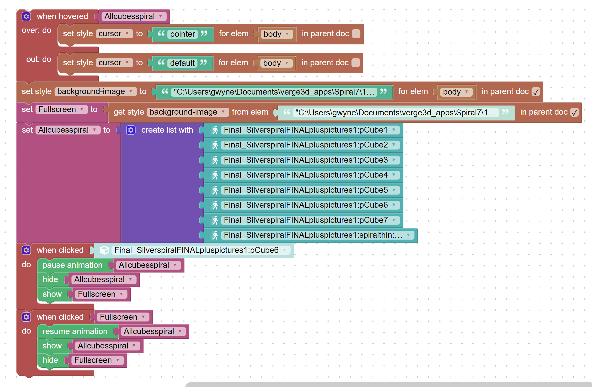

    I’m having trouble using puzzles to open an image fullscreen by clicking on an object. The puzzles I’m working with are below. The click is responsive, but doesn’t open the image.
    Thanks for your help,
    Gwyneth
    #52160
    it looks that currently you are using absolute paths such as C:\Users\… Instead, you should just leave the file name (provided the file is present in your app folder).

    gwyneth
    I tried just the file name (the file is in my app folder), but it still won’t work. I have a feeling I’m not using the set/get style puzzles correctly, but there may be a different problem.

    Indeed, the correct syntax should include url and brackets:
    https://www.w3schools.com/cssref/pr_background-image.asp

    gwyneth
    Hi, I’m still having trouble. Do you have any samples with the puzzles opening images fullscreen? Do I need to write some html/css code to go along with the set/get style background-image puzzles?
