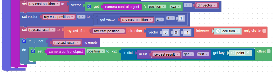

    seans
    kdv,
    Your example works. I tried it from the link you provided, but when I apply the puzzles to my example, I can’t get it to work. I cleared the browsing cache and cleared the example files from the server and republished my example. Did you do anything else besides the puzzles?

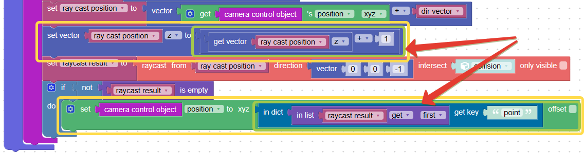

    #81056
    seans
    See attached image of what I did. I see only one difference.
    #81058
    have no idea why it’s not working on your side :unsure:
    #81059
    oseans
    <iframe title=”How to make steps or ramps work in VR mode in real time” width=”640″ height=”360″ src=”https://www.youtube.com/embed/vCNoOVa24lw?feature=oembed&#8221; frameborder=”0″ allow=”accelerometer; autoplay; clipboard-write; encrypted-media; gyroscope; picture-in-picture; web-share” referrerpolicy=”strict-origin-when-cross-origin” allowfullscreen=””></iframe>
    I finally got it to work from your video. I did exactly what you did and got it to work. I must have been using a slightly different puzzle or something, honestly not sure why it works now. Thank you for your time. This will really help me in a huge project I have been working on. :yahoo: You are awesome!
