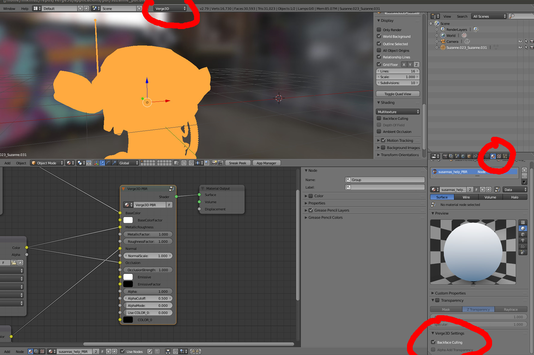

    how to make double side normal in blender ? verge3d node double side scroll 100
    #5455
    You need to switch to Verge3D engine and in the Material setings in the ringht panel under the Verge3D Settings tab switch off the Backface Culling checkbox.
