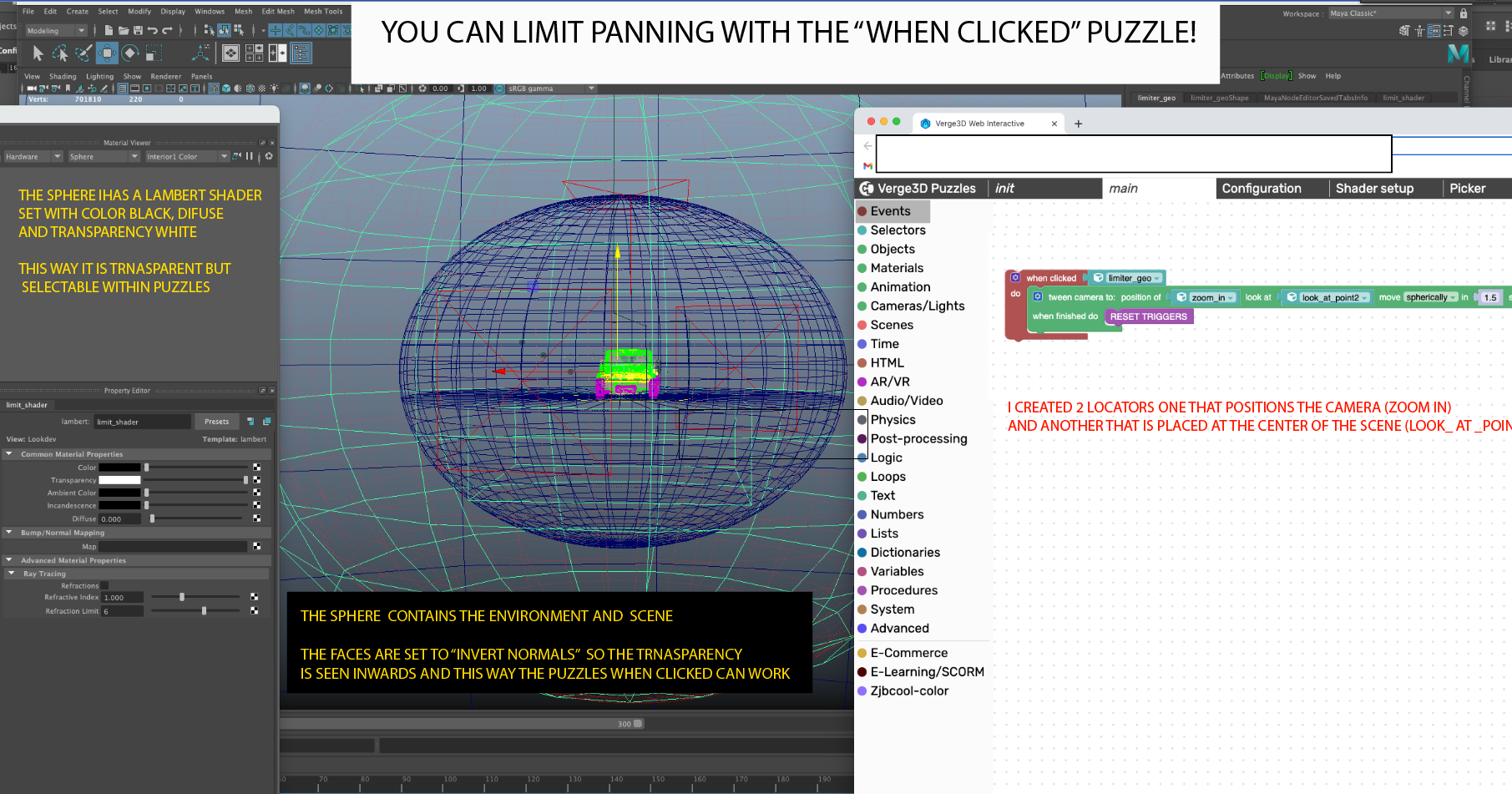

2022-08-25 at 12:35 am #55209
David YanezCustomerIs this workflow possible for Maya? How can you restrict the translates up to a certain point but still be able to pan within the app? Is this possible?
Cheers!
2022-08-25 at 2:59 am #55211
David YanezCustomerThanks for the tip! I came up with a solution using the events puzzle “on click”. What I did was to create a sphere that contains my whole environment and set its shader with a lambert set to transparency white, color black and diffuse 0. This makes the shader completely transparent, but still clickable within the app.
Then in puzzles I used the “when click” puzzle and set it so that when click on the sphere the camera would animate to a locator set to the middle of the scene, thus limiting the pan movement navigation.
I hope this helps others as it did me.
Cheers!
