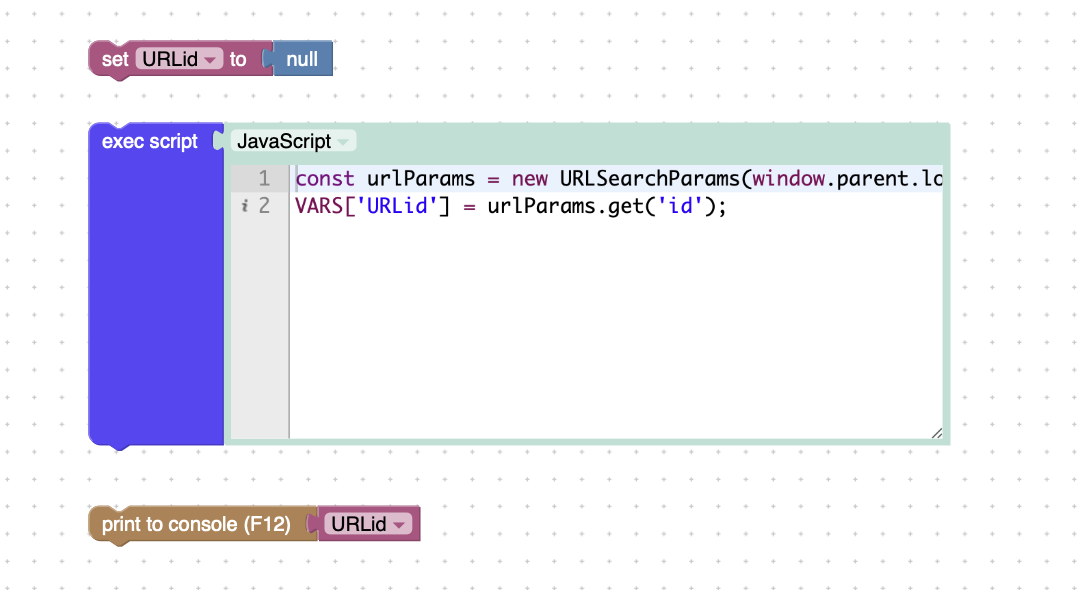

    Hi all.
    I don’t find solution on forums or under help on how to put together puzzles which gets value of variable (URLid) that was coded in exec script (see below)?
    `const urlParams = new URLSearchParams(window.parent.location.search);
    const URLid = urlParams.get(‘id’);
    #85891
    Sorry for the late reply, your post mistakenly got into the spam. To retrieve values from the “exec script” puzzle you simply create a variable in Puzzles and then assign it via the VARS object as follows:
    assign variable from the exec script puzzle

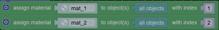

    Multi-material index problem:
    I don’t know if it is proper forum section but, I get error in console if I want to assign some (sub)materials from multi/sub-object material to other objects with certain material IDs set in 3ds max.
    I get error: “assign material puzzle: Invalid material index 2”.
    “All objects” selector probably doesn’t work with that puzzle (see in attachment)?
    • This reply was modified 5 months, 1 week ago by novator83.
